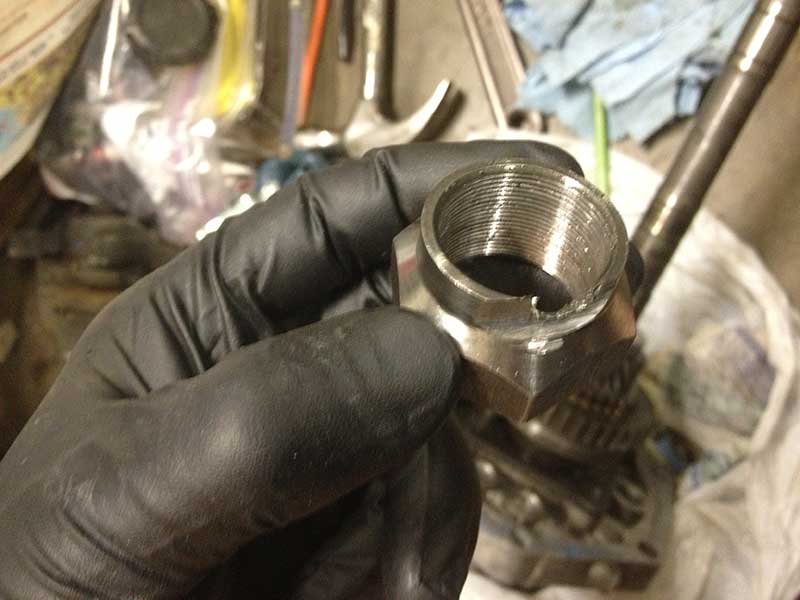

I'm also rebuilding transmission now.
Does anyone know where I can purchase those nuts?

I order the nuts.
Last night, I finally removed the punched nuts. I try to bend back the punched area of the nut did not work. Finally, I grinned it carefully not to damage the main shaft, and successfully remove the nut!
