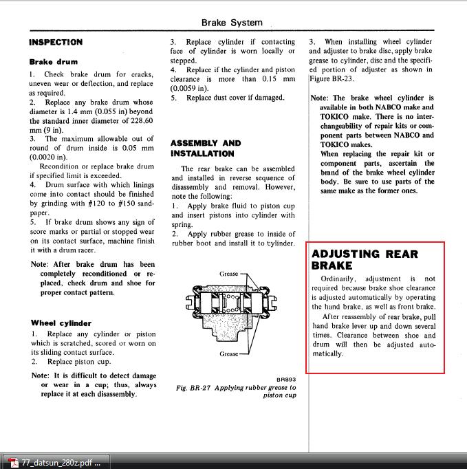

First apply the handbrake a couple of times to adjust the rear brakes.
FYI, this is not the proper way to adjust the drums, refer to the FSM. You won't have full braking performance unless they are adjusted correctly.
I thought I was quoting the FSM for the 280Z??
I was unclear, sorry. You're correct if the shoes haven't been messed with and the handbrake is correctly adjusted. I think I mixed up the FSM and John Coffey's (I think?) suggestion based on his experiences.
FWIW, a worn/maladjusted handbrake will not allow full adjustment of the rear brakes.
