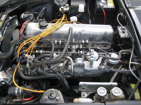

That canister is the coil, if it doesn't fit snug it's probably not the original one, not a problem though. Standing at the drivers side front tire looking at the motor the Fuel Pressure Regulator will be in the center of the fuel rail, tube that goes to all the injectors, it's about the size of a 5oz cup with a small hose for vacuum and 2 or 3 fuel hoses connected to. In this picture it's about 10" down from the "C" on the valve cover. Small can looking thing with a lip around the center where it is joined together. Hope that's understandable, little fuzzy this morning.
