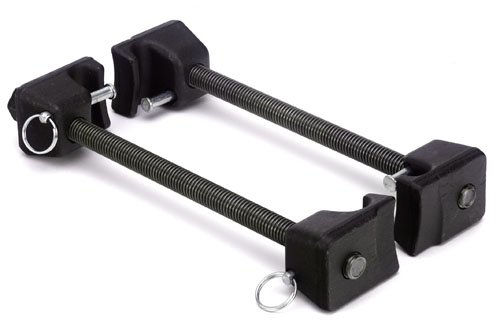

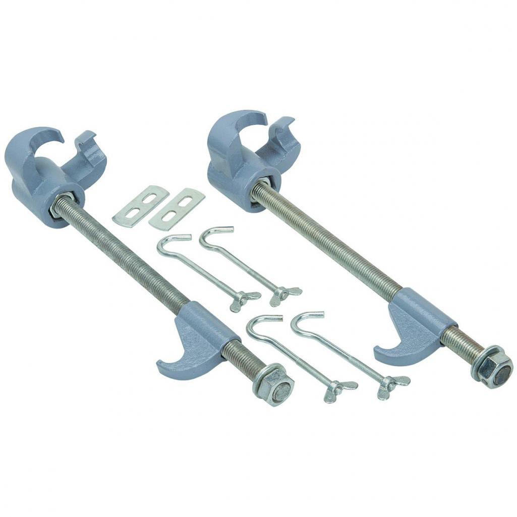

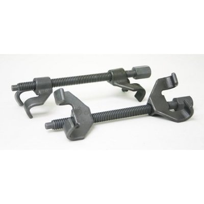

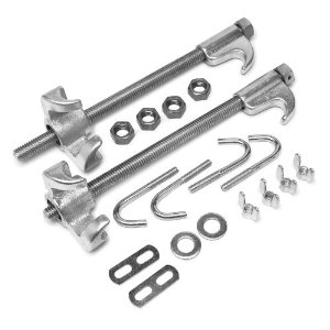

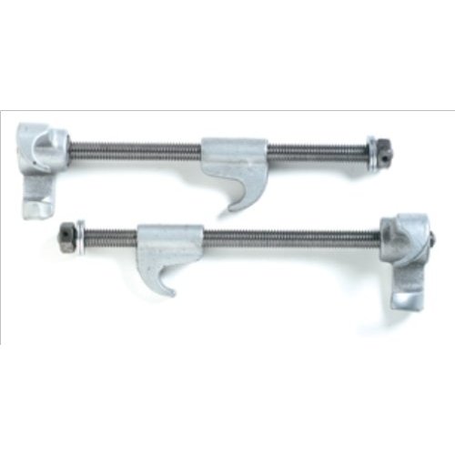

I have used my 25+ year old strut spring compressors more times than I can count and they getting really worn out. The threads are worn and I have sheared the roll pins several times due to binding. Mine have only a single hook at each end with no safety pins or anything else fancy. Even my simple compressors have trouble fitting between the coils. Is there a brand that fits our coils while still on the car (swung out) and is made well? I looked around the web and there are many styles, but none like the ones I have been using since the mid-80's. I'm pretty sure that anything with a double hook will not fit well. Some of them also have a safety pin that holds the coil. That too seems like it wouldn't fit on a S30 spring. Others have a secondary hook at one end.
Here are some examples of what I have found. Do any of these work well on a S30, or does anyone have a favorite brand that fits well on a S30?
