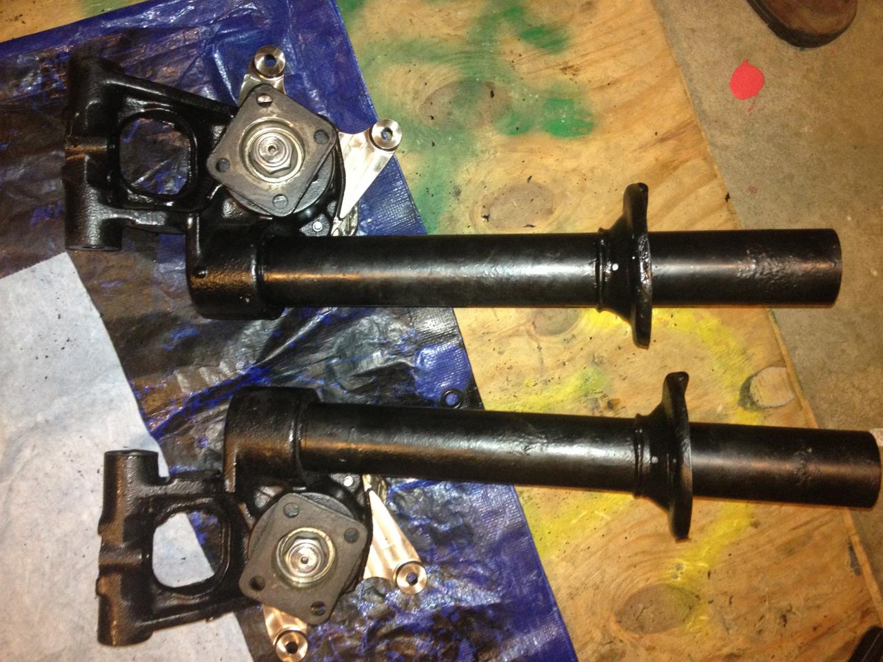

Thanks to all! I have installed the bearings in both struts and torqued them. Everything feels right this time. Is was a little tense rehabilitating the stub axle threads that I damaged. A steady hand and patience seems to have been the right combination. I have not peened the nuts yet. I know that as soon as I do there will be something I forgot so I'm going to hold off for now. I have the tabs for my discs installed also.

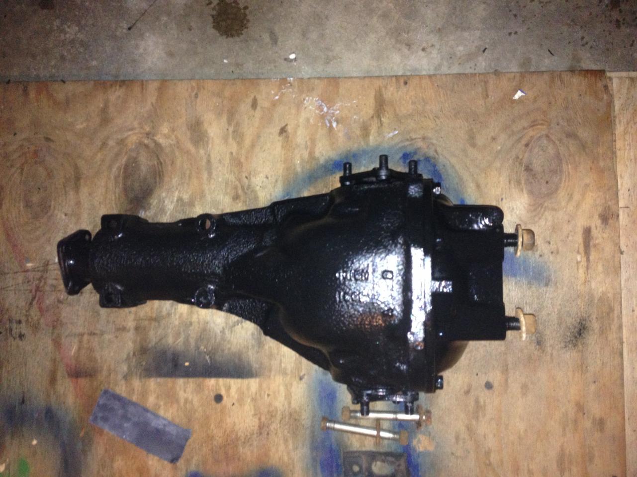

Thanks all for the replies. Tomorrow is "differential day". I'm gonna clean it up and then see what the fluid looks like. If it is good I will leave it alone. If it looks bad then I guess I will rebuild. Wish me luck. I'm anxious to get all this stuff tucked back underneath the car where it belongs, but I don't want to do a half assed job!

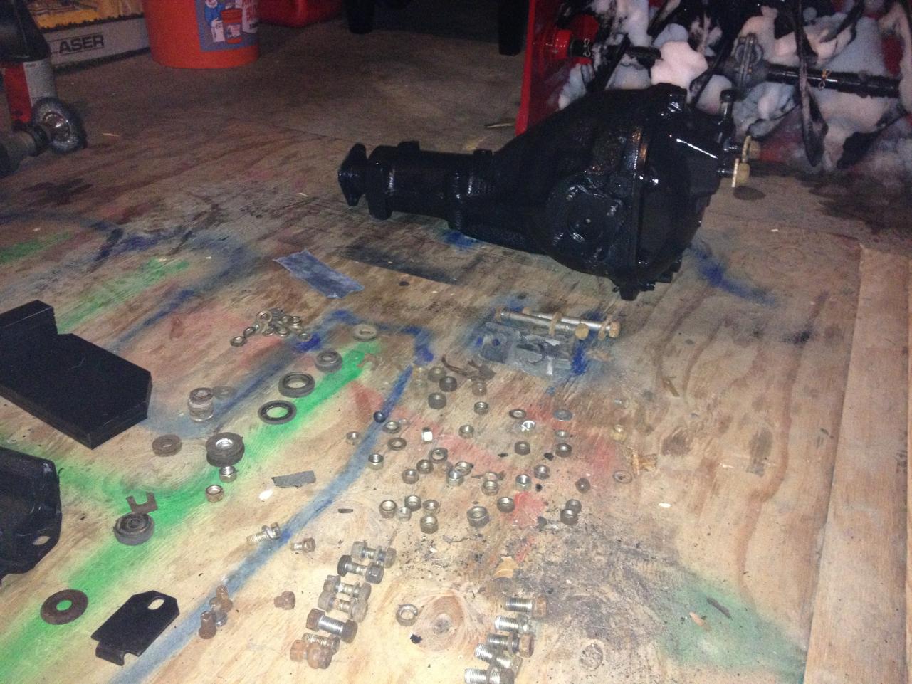

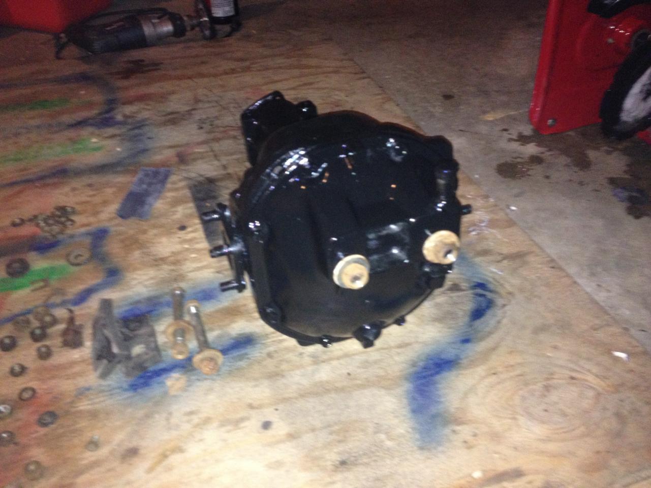

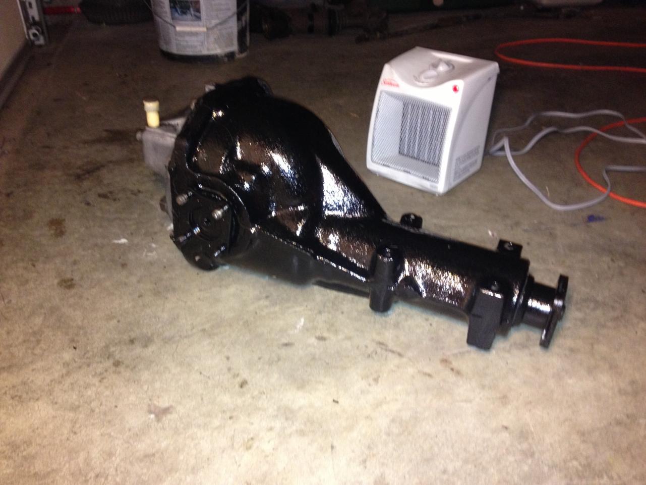

I made some progress today despite the fact that we didn't have power until close to 1:00 pm. I cleaned up the differential and checked the fluid. It looked very good so I painted with POR-15. It will get a coat of flat black tomorrow.

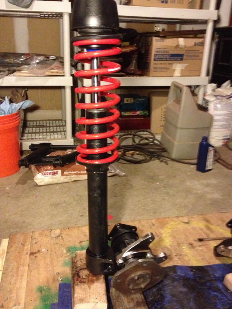

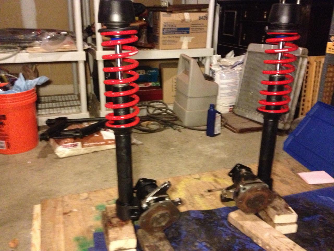

I also assembled the struts. Here's what they look like right now.

Good news with your diff. Did you change the side seals and the cover gasket on the diff? Just looking at the first photo, looks like its weeping from the seals or cover gasket.
They are simple to replace now its out of the car. I cant remember the price exactly but it was less than €20 at the nissan dealer for 2 seals, gasket & new breather.
I would not do the front seal, it looks good in the photo, no leaks. If you replace it, you can mess up the pre-load on the pinion bearings.

Nope, I didn't change the seals. I thought about it, but the grime you see was from the u-joints slinging grease. The diffy actually looked really solid much to my surprise.

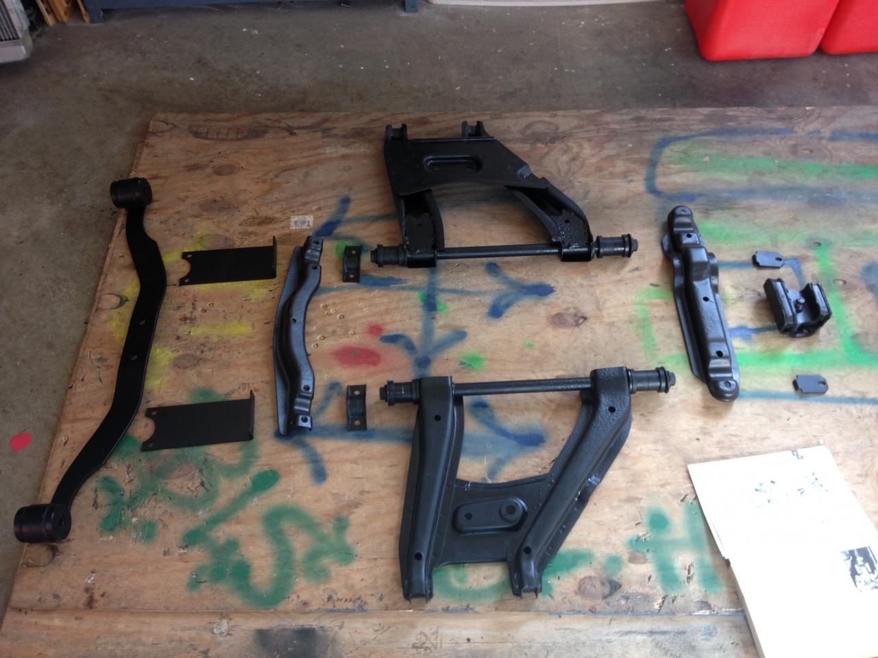

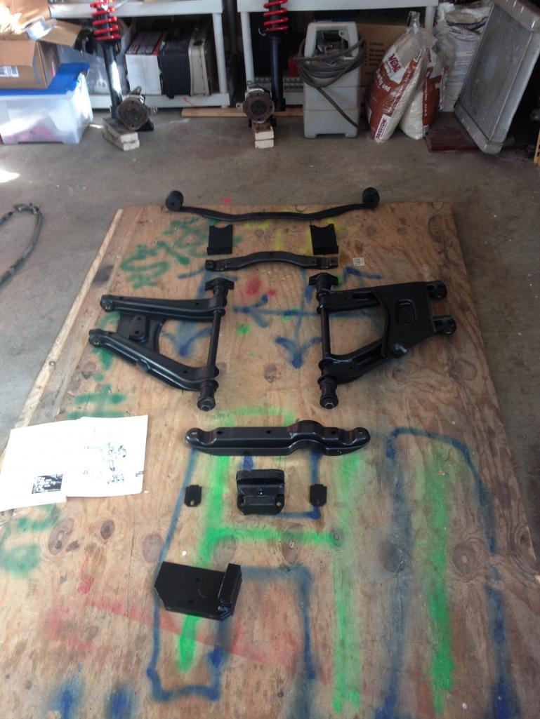

I laid the parts out to prepare for reassembly and took a photo of my crappy brake lines. Most of what is shown in the photo has been pulled. I rebent new lines from the T-block tonight.

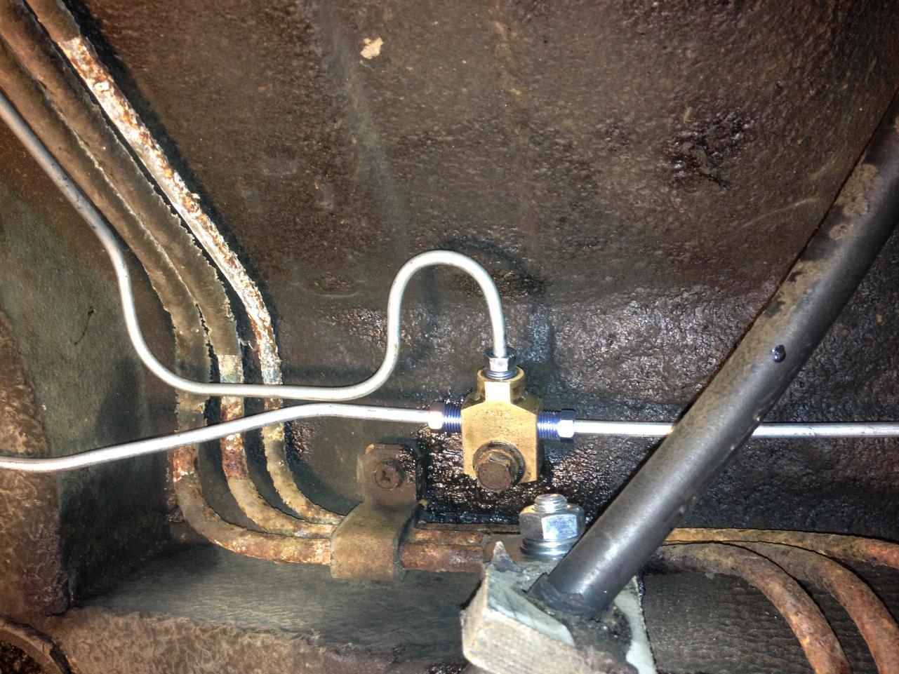

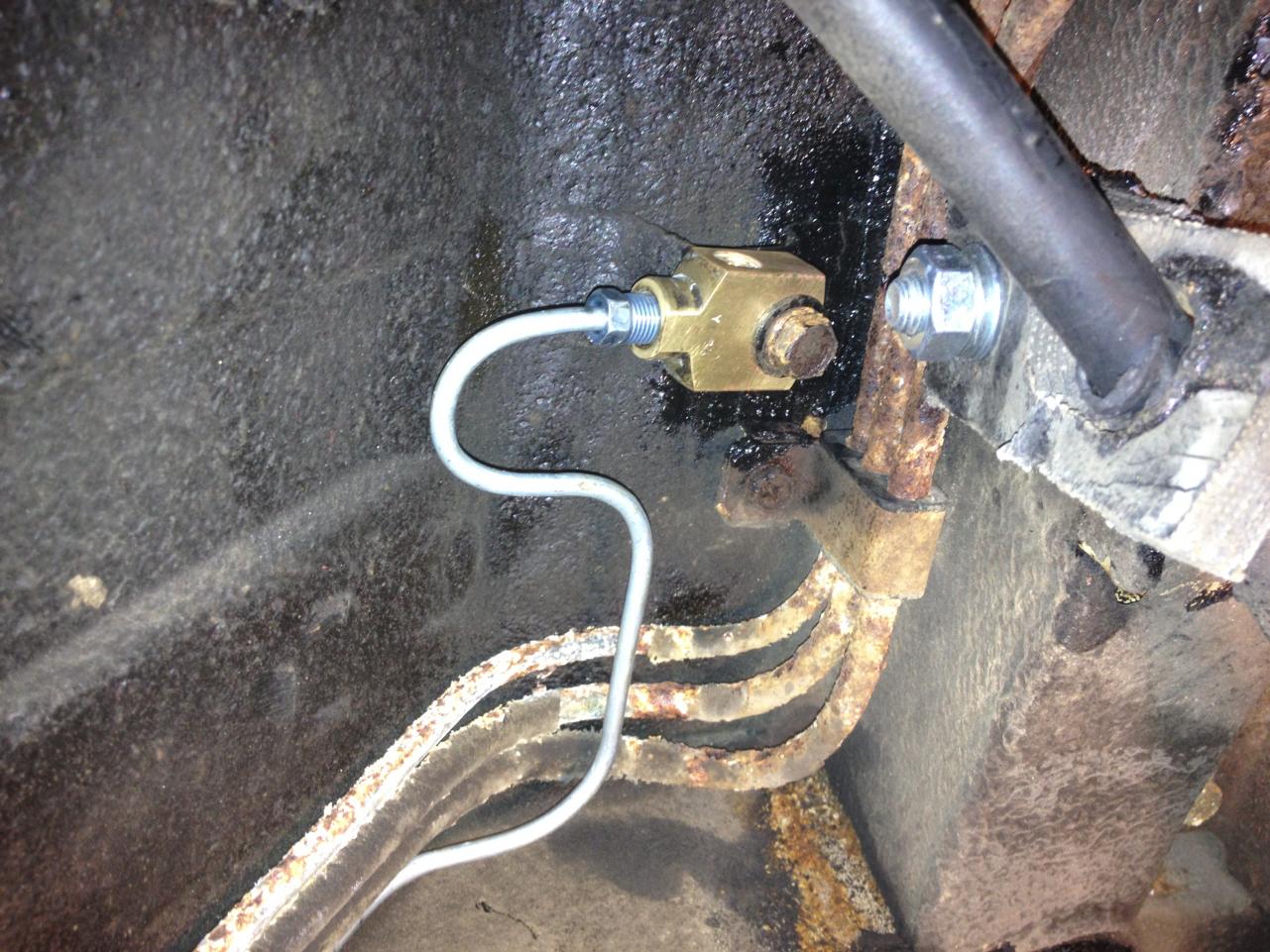

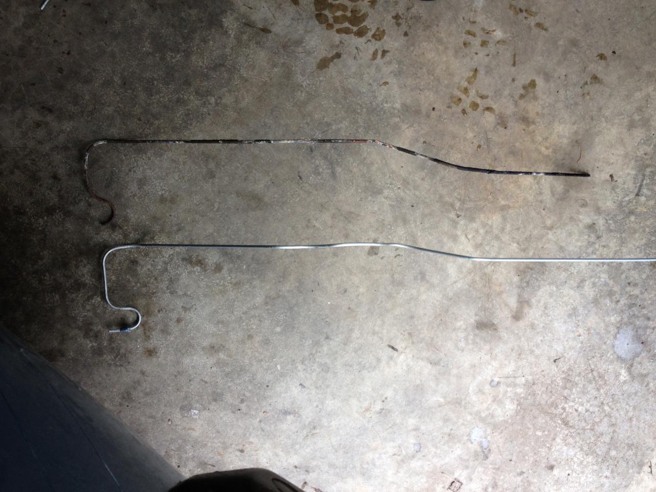

I have been agonizing about my rear brake lines. They were heavily corroded and I couldn't get the flair nuts off. Even with a lot of PB Blaster and waiting. They just wouldn't let go. After much soul searching and internal debate, I broke out the dremel and cut the lines at the nut. The I rebent new lines using the old ones as templates. Here are the results. I am pretty pleased with how it turned out. There was a lot of labor involved and lying on the floor which isn't fun because it's 30F here and snowing outside.
The main line to the "T" old next to new:
The new main line and cleaned up "T"

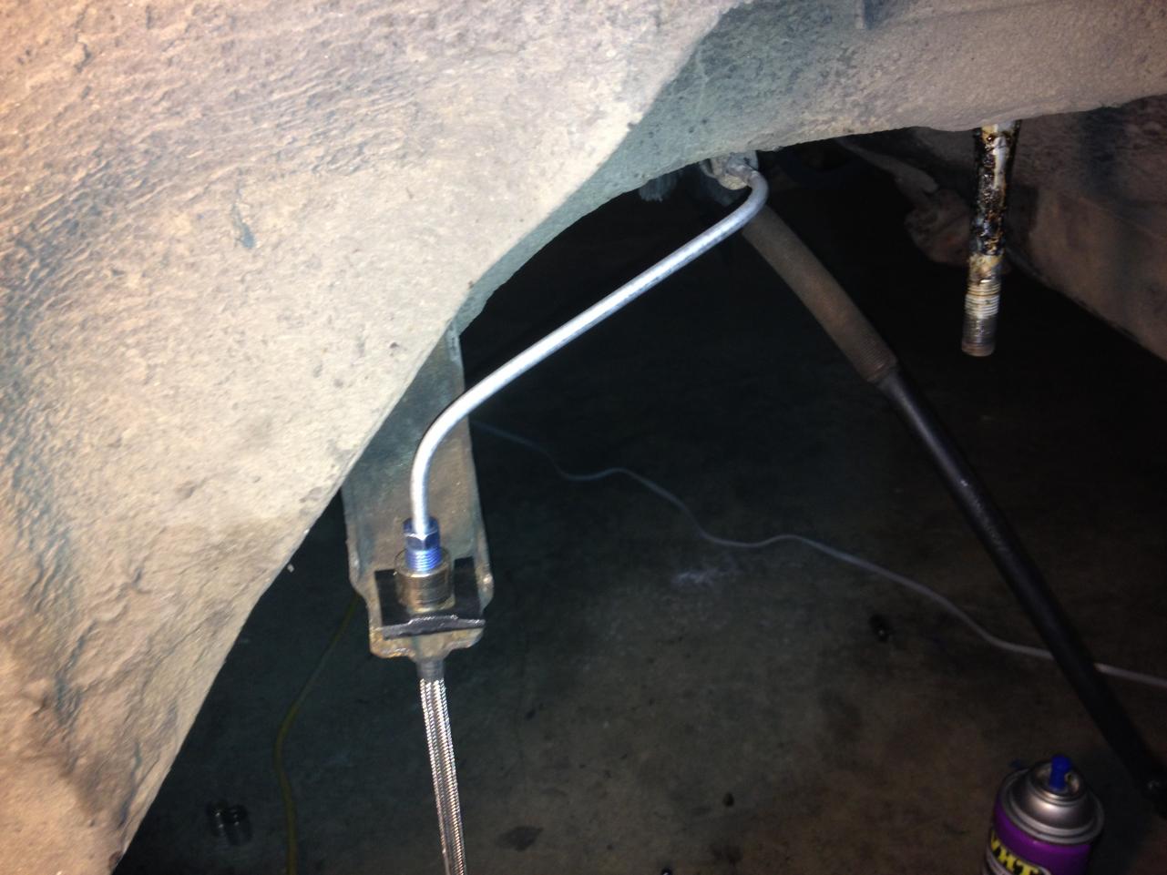

The "T" and the new lines to the wheels:
A view of the completed install from the rear driver's side wheel well:
A little commentary is probably due here. There is a lot of stuff under there that I am leaving alone right now. I really had to resist the urge to pull the fuel lines because they look like heck. The brake line looked about that way when I started. It's hard, but I will be doing those later when I pull the gas tank and restore it. The only reason I am holding back is that I don't want to take my road-worthy car and turn it into a 2-year project that may never get done. My logic right now is to take small bites and finish the jobs completely. In the long run it makes more work, but in my own mind gives a higher chance of success and shorter intervals with a non-drivable car.
