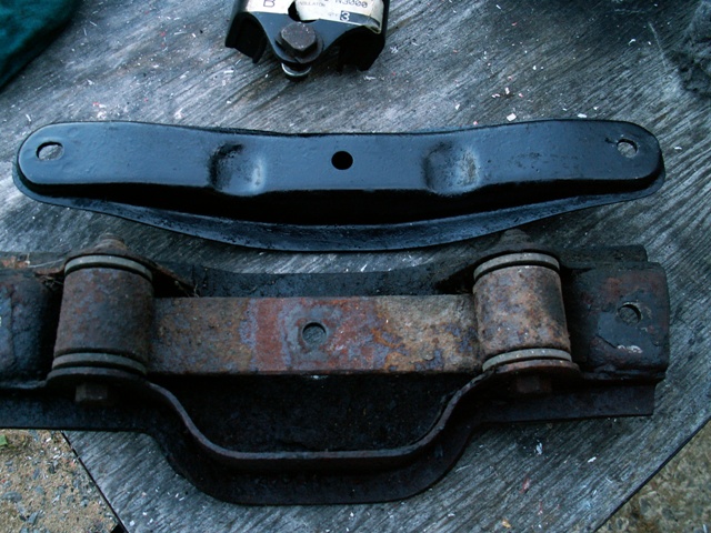

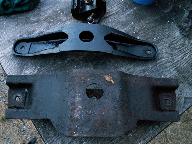

I pulled the transmission and engine out almost 2 months ago now and I can't remember which mount was on the car holding the 5 spd tranny. The second mount was in a box of extra parts that came with car.
Which one is right?

The shiny black one is from an Auto Z. I had one on my 240 with a five speed for a while, and then fitted a manual mount, similar to your old looking one.
I could tell no difference in the way it functioned.
The older one is from the manual trans. Either will work.
........and just like the one I removed from my automatic 72 that I converted to manual. I reused the same mount on the new 4 speed. It works for auto or manual.
Well there ya go . Maybe they made special manual mounts for NZ. rough roads. or JDM vehicles.
Mine is a 72 auto/manual conversion as well, and came with the same type ie the shiny black one. The other type of mount I fitted later came off a 72 manual I was told.
Is there some crossover of mounts.?

Well that is strange, never seen a question yet that stumped this forum. :)
I just assumed that one was for the 4 spd and the other for the 5 spd .
The weird thing is that the bigger rusty trans mount not only has that flat spring but is built to handle at least 4 times the weight of the smaller shiny mount. The smaller mount weights maybe 1/2 a pound if that, the larger one probably 4 lbs.
I guess I'll use the lighter one since it seems to be working for you guys.
Thanks,
Chris
