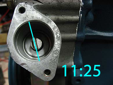

^^^^This is what my timing is at. Can anyone verify if it's correct?
^^^^ This is where my my distributor timing was at when it wouldn't start.
^^^^ This is what I had to turn my distributor to for my car to actually start! so how bad is my ignition timing? Am i off a teeth? and what do you guys think about my mechanical timing? thanks
Does it run right with the distributor turned into the position in the last pic? If so, the problem has to be the oil pump shaft. If the cam timing was off, the engine would make very good power. Everything *looks* right per the pics, but we haven't seen the distributor shaft. Can you pull the distributor out and take another picture with the engine at #1 TDC. We are looking for a good pic of the distributor end of the oil pump shaft. That will tell us if it's off a tooth or more.

I think 11:25 is right angle.

With your dissy adjusted the way it is in the pic, your oil/distributor spindle is off proper timing too.

I think OZ is "Dead On"! The timing mark is too far to the right of the notch, therefore the cam is one tooth too advanced. Your distributor seems to be OK though, because you set it at 11:25 with the piston at TDC compression stroke that should be correct. That's why they put timing marks on timing chains.....to get things lined up correctly. You always want to rotate your engine 360 degrees to make sure there is no valve to piston interference in case of missing a tooth before firing up a new engine.. IMO
