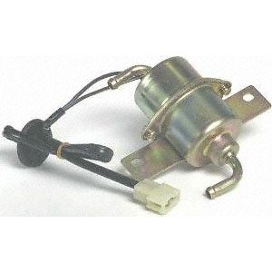

So, with that being said, I decided to ditch the pump and take the advice of many members on this board and go with a 1981 RX-7 electric fuel pump. To say this is quiet is probably the biggest understatement on earth. It is just dead silent. I left my Holley fuel pressure regulator in place and wide open it allowed the pump to put out 2.7 psia to the fuel rail with the engine running. I may need to remove the regulator as, it is not really needed with this pump with everything I have read. I was running the chainsaw pump at 3 psia. I have not done any long 4th gear pulls to see if 2.7 is enough, but I think it will be fine.
Anyway, this is the pump I ordered from Rock Auto..
It was only 42 bucks and arrived in 2 days. I recommend it completely.
Not sure, as this would seem to be better suited to a diaphragm type of pump where the pumping pressure oscillates between high and low pressures. The RX7 pump is more of a rotary pump with constant pressure like the CARTER was. I could really see that being useful with the OEM mechanical pump.
Welcome to the rx7 pump club. Have the same pump in my car- very quiet. So quiet I left the ignition on all night with the pump running- still going strong
I ordered one from Amazon a few minutes ago. Silverstreak1971 had told me to get one as I complained about the jackhammer that was the fuel pump I got from Summit Racing. Sad thing is the Summit Racing model I got was about half again as expensive.
Do you know how much GPH the pump is rated for? It could be a interesting alternative to after market pumps.
I'm currently running a Mallory pump because of its supposely quiestness & flow rating. It is much quieter than my previous Carter pump I had before but I can still clearly hear it, only at idle though.
[edit]: I found the answer on rockauto spec sheets: 30 GPH.

I have run the 1979-1981 RX7 pump in both my track and street car. I'm using a little different style pump than the one shown above.
Great little pumps, quiet and so far very reliable. However, I ended up recently changing to the Carter in my track car as I found that I could out run the pump at WOT in 4th near red line at the end of a long straight. It wasn't a problem until I switched from 34mm to 37mm chokes in my Mikuni's. I don't see this being an issue for a street car and I will continue to run the RX7 pump on the street. I thought I would share my experience for those who run on the track. If you see your AFR's drop off at high RPM's then you might look at installing a fuel pressure gauge in the cockpit. Just sayin';)

Ok, thanks to Amazon for the quick delivery, my new RX7 fuel pump arrived yesterday. I installed it a few minutes ago and all I can say is HIGHLY RECOMMEND! I now have no fuel pump sound at all. I have a permanently installed fuel pressure gauge and a fuel pressure regulator in my engine compartment and what was 2psi is now 2.5psi. Silent and efficient!:classic:
