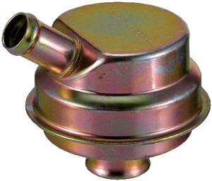

I am currently using a generic $6 crank case breather on the end of the PVC hose as an interim road-draft tube (I just put Webers on the car).
It hangs down near the corner of the inner fender and the rad support for the moment

I agree, a rebuild seems unwarranted at the moment. The primary problem seems to be a lack of constant movement of air through the crankcase to remove moisture and other gasses. At this point even a road draft tube would help.
