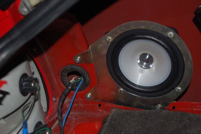

The single speaker in the 240Z was on the left side, as shown here (with a Kenwood speaker in the stock bracket):

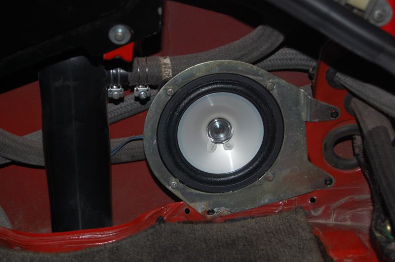

I re-bent a second stock bracket to put a second speaker on the right side (same Kenwood installed):
Hey, Arne. I did the same thing in my 240Z turbo. I think I used Kenwoods too.
Chuck
The Kenwoods were one of the few I found that would fit. You can't use a speaker that has a protruding tweeter back there, the plastic panel sits too close to the speaker.
