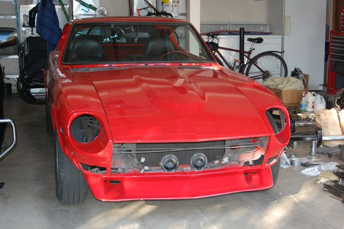

Here is my before and after. I went with a gloss finish on the repaint to reduce the amount of dirt that might stick. Don't overlook painting the five tabs for the grill mounts.
Jim
