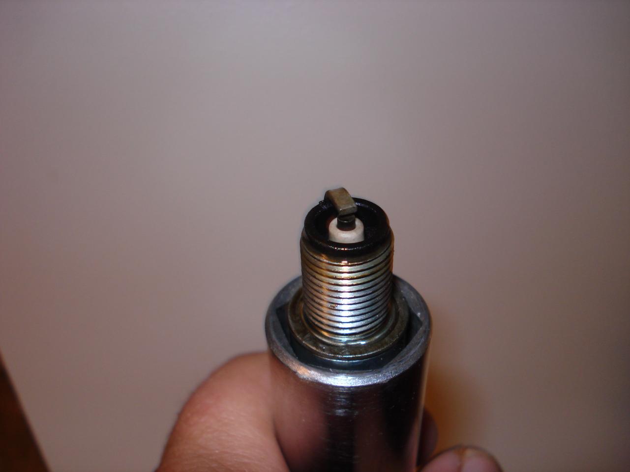

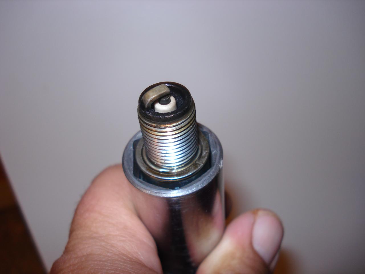

Almost forgot something important. My wife and I jumped in the Z and drove it down the PCH through Malibu to Santa Monica and it ran ok if we were driving and not going through stop and go traffic. It was nice to get it out and run it. But, by the time we got back home it was really running rich. I had my wife rev it a couple of times and it was blowing black smoke out the exhaust. And I leaned it out by 8 teeth before we left on the drive. So I pulled a couple of plugs and they look good to me.
Edited by rcb280z
Blue, I agree with you. But if you could experience how it is running you would think different. That's why I pulled the plugs because I expected to see them fuel fouled. 16 miles per gallon is all I got yesterday on that short trip. City and highway driving.
I'm not getting it either. The black smoke says rich, but those plugs look lean.

Hey guys, sorry it's taken so long to get back to you. They are the stock heat range. B6ES11. Capt. Obvious, yes I do have a CAT and it's not even 2 years old yet but have contemplated taking it in for a new one. They are not too expensive. I couldn't tell you anything about the composition.
It looks lean.
