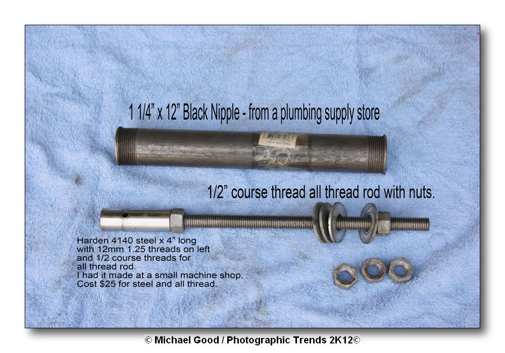

May 2, 201213 yr comment_388886 This is what I had made at a local machine shop. Cost around $25 plus the pipe. The end that attaches to the spindle pin is the same thread as the wheel lug studs. Worked great, I used a large boxed end wrench and hit it with a hammer to help turn the nut at the washer end. One of my rubber bushings did split down the middle and I had to saw the sleeve out of the frame. Link to comment https://www.classiczcars.com/forums/topic/40777-spindle-pin-removal-tool-survey/?&page=4#findComment-388886 Share on other sites More sharing options...
