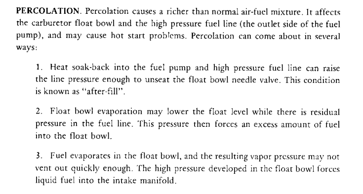

May 6, 20178 yr comment_520042 @jalexquijano, I'm still gathering heat soak puzzle pieces and trying to fit them together. Nissan says that fuel percolation occurs between the f. pump and the carbs and will cause an over rich condition. Vapor lock, on the other hand, occurs on the suction side of the pump. This got me to thinking about heat sources on the suction side of the pump. Taking into consideration all the work you've done under the hood to stop the problem, is it possible that the fuel is actually getting over-heated, in traffic, in the fuel lines under the car in the tunnel? My 240 tunnel used to get very, very hot, in traffic, in the summer. I can't imagine that a new exhaust with larger pipes would help either. BTW, I don't remember if you still have a mechanical pump along with your electric one (both are supposed to help the problem) Â To anyone, Was the fuel line location under the tunnel ever changed through the years? I'm still gathering puzzle pieces. Link to comment https://www.classiczcars.com/forums/topic/40289-vapor-lock-questions-for-the-hotter-climate-guys/?&page=27#findComment-520042 Share on other sites More sharing options...

July 23, 20232 yr comment_655335 That would keep the fuel in the line at radiator temperature while the car sat. Probably around 150 F, guessing. Not good. Besides that, if the problem is after the car sits, it's most likely the float bowls boiling dry. Do you have an electric fuel pump or mechanical? Edited July 23, 20232 yr by Zed Head Link to comment https://www.classiczcars.com/forums/topic/40289-vapor-lock-questions-for-the-hotter-climate-guys/?&page=27#findComment-655335 Share on other sites More sharing options...

July 23, 20232 yr comment_655339 I don't know how the relay associated with that retrofit works but, if it was set up likes today's EFI engines it would have a 5 second run timer as soon as you turn the key on, to refill the float bowls. Other carb guys know more. Nissans document describes what's happening pretty well. Percolation, they call it. They talk about being too rich but if the boiling continues for long eventually you end up at too lean. Anyway, their descriptions might offer clues. Good luck. Link to comment https://www.classiczcars.com/forums/topic/40289-vapor-lock-questions-for-the-hotter-climate-guys/?&page=27#findComment-655339 Share on other sites More sharing options...
