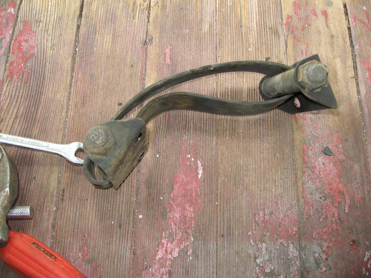

and good riddance:
the rt mount is the easiest upgrade so far, 14 mm wrench, socket and a hammer to persuade it a little. Oh and a sharp knife to remove a little from the bump stop. the clunk is gone! :cool:
With all those RT mounts now in use, there must be one heck of a pile of used diff straps out there somewhere. I know I have quite a collection now.

Agreed. Not just the lack of clunk, but the big reduction in lash (or slop) in the driveline when getting on and off the throttle. And with no change in NVH. This is one of the biggest improvements in drivability that I have done - ranks right up there with the improvement in freeway stability from the spook.
Maybe a brand new strap would do as well, but I doubt it.
