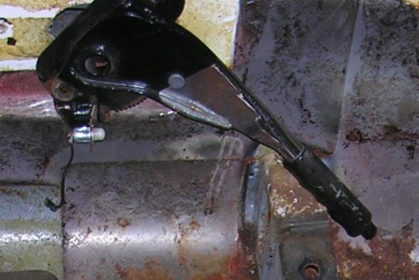

My '72 emergency brake handle was pretty beat up. I looked around a bit at buying a new one and then decided to try and fix my old one. The first picture is a severely cropped shot of the interior showing the brake handle before any work. The second picture shows the brake handle when I was done.
The process was fairly simple: Sand out all the bad stuff with 100 grit, than 220. Then smooth it further using ScothBrite (burgandy grade grit) finally polishing it with my polish wheel on my bench grinder. It's hard to get a good picture of a shiny black object, but I'm pretty pleased with the result.

I used a 6" cotton polishing wheel (from Harbor Freight) on my bench grinder which turns at 3500 rpm. The polishing compound is the "Brown" compound also from Harbor Freight. I was a little worried about burning, but it didn't seem to be an issue at all. There was no paint involved, just sanding and polishing.
