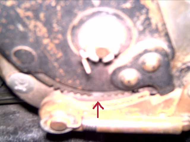

My drivers seat rocks back and forth and I can't imagine Nissan meant for this to happen.
The bottom piece of metal with teeth moves up and down but only when the seat is in a normal driving position. When I lay the seat back (undrivable) it doesn't rock. See photo for the piece of metal I'm refering to (sorry but it's a bit blury).
Is there an easy fix short of buying the whole set for the reclining mechanism?

Ozzy, does the whole seat rock or just the seat back. If it is the whole seat you will find the attachments under the slider rail front or back may have loose nuts. when you look at these four bolt threads you should see directly below the slider rail a single plastic spacer on each position or maybe even more than one if the last owner was shorter than average this is where the nuts are that may need tightening. If it is the seat back only moving check the mechanism attachment screws for tension and movement tighten as required. If it is the actual mechnism lock and ratchet tongue you may be able to shim it out a bit. I have never attempted this shimming thow.
Good Luck
Steve :classic:
