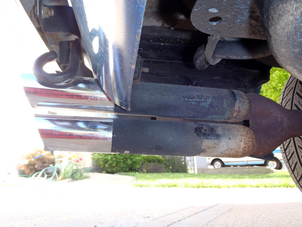

Customizing my MSA flanged exhaust
Arne
Congrats! You just joined the group of us who suffered through the same drone-ing MSA kit's trial-and-error solution.
Look on the bright side ... at least your dual vertical outlet looks darn cool!
Well, to be fair, I've heard fewer droning complaints on the Premium flanged system than the earlier non-flanged. Mine didn't really have a "drone", but it did have a resonance period at 3000 RPM where it was darned loud. Similar issue, I'm sure.
I also suspect that had I used a bigger Magnaflow similar in size and shape to the supplied Dynomax, that the system may have been quieter. The small dual outlet muffler is not a quiet one.
On the bright side, yes, it looks good, sounds good and fits good. It did cost way too much. Trying to adapt an off-the-shelf system is fraught with extra expense. I like the rear muffler and tips, but if I were to do it over I'd do that myself and then hand it to the muffler shop to build the rest.
Update - the removable tips was a great idea! Took them off to clean yesterday. Super simple, works great.
Note to any looking to use this dual outlet Magnaflow - resonated/glass-packed tips are needed on a medium-to-large diameter system. The glass-pack in the tunnel of my car is 22" long, and 2¼" inside diameter. With that glass-pack, the combination of both 2¼" and 2½" tubing, the Magnaflow, and the glass-packed tips the exhaust is good. Nice sound, authoritative, but not too loud. Remove those tips and the volume goes up considerably. It would be too loud again without either the tips or the tunnel muffler.
