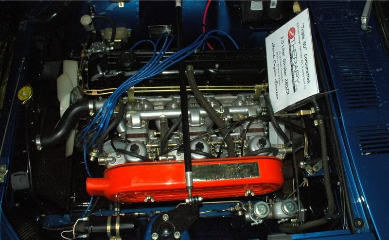

The triple setup Steve did performs beautifully. The first year he had them on the white car, the run to Orange and back netted about 28 MPG. They have been flawless. And after that show I had people comment about how clean that engine compartment was at the show. When I asked what they thought of the triple carb setup most said they didn't even noticed them, the job he did was that subtle.
The blue car they are now on belongs to a friend here locally and I don't know how that happened..... nyuck nyuck
I think they were on the white car when I saw them at Solvang. The car sounded real smooth to me. My wife even commented on how nice it sounded and she really isn't that into cars.

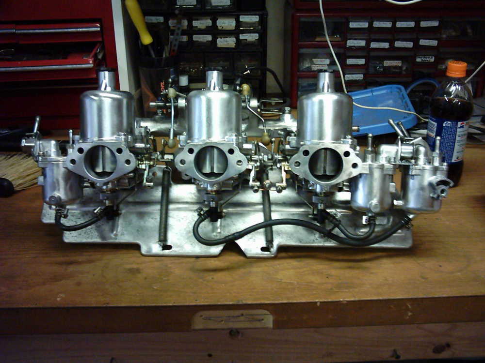

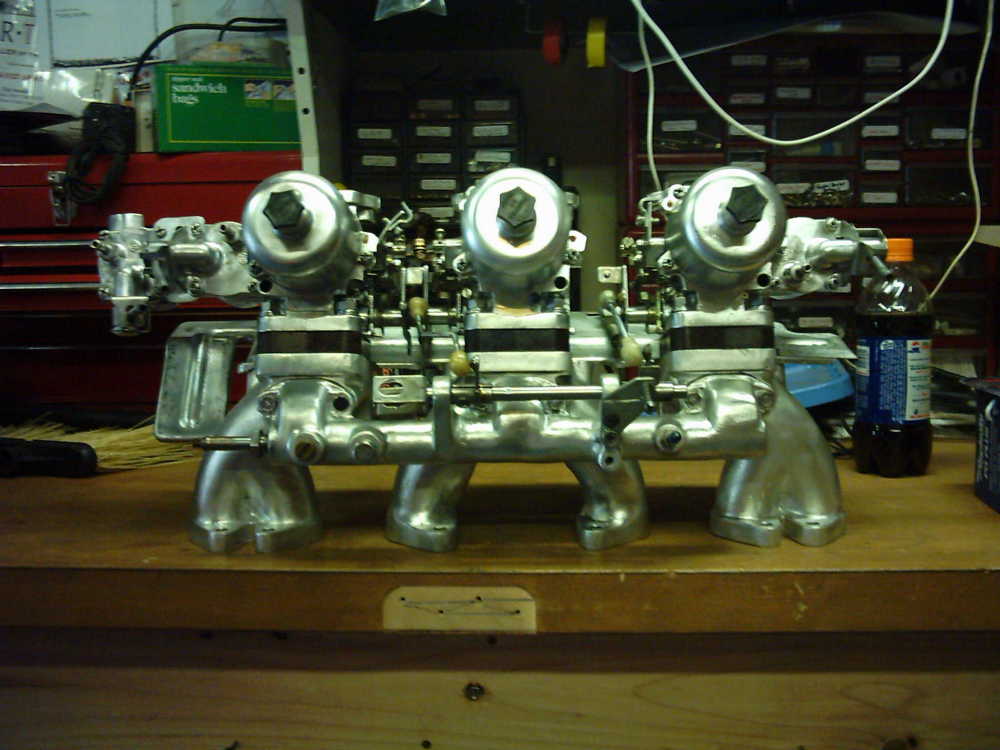

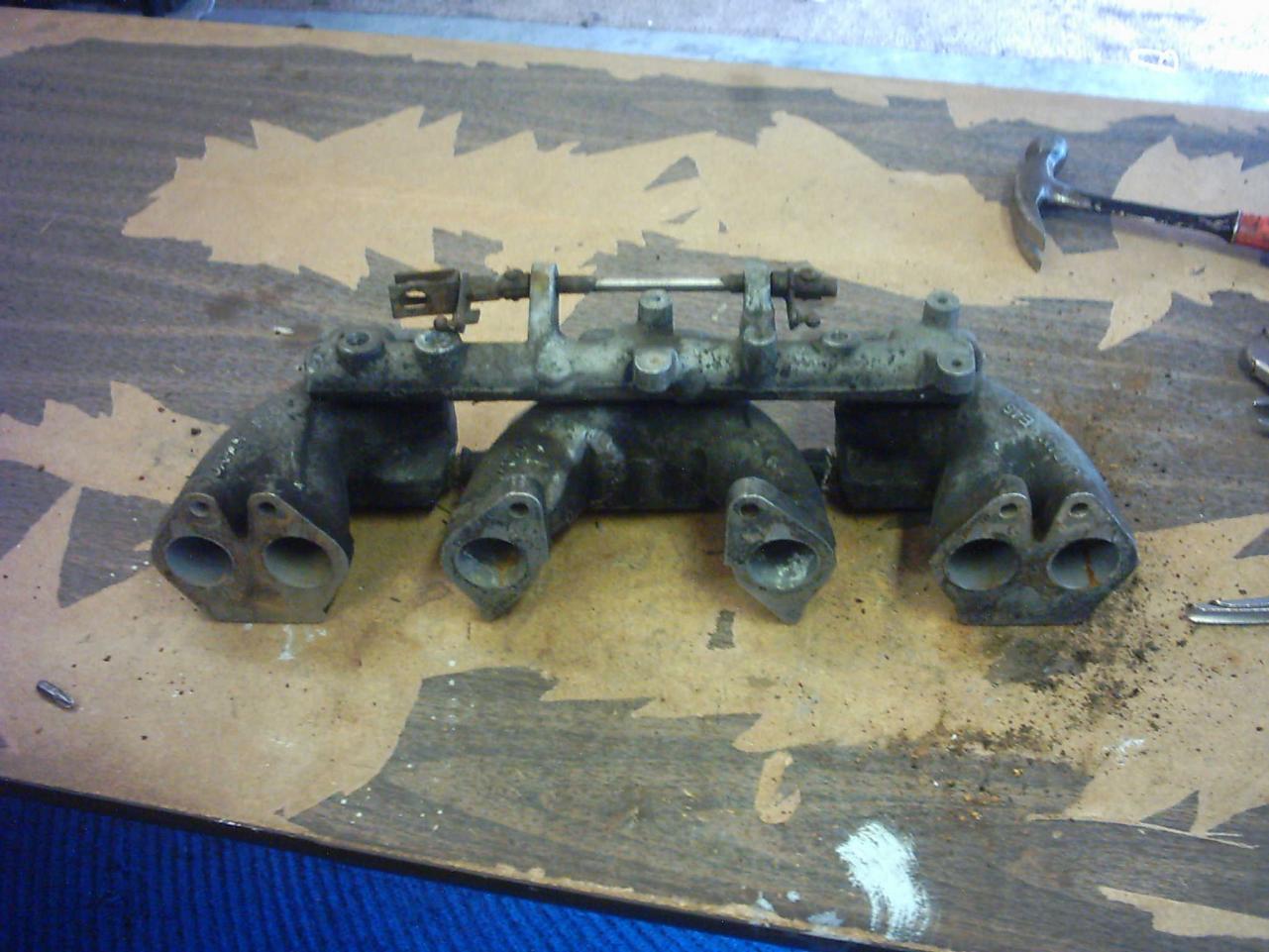

I also had a set of triple SU's a few years back. They ran ok but I was too much of a novice to tune them correctly. I sold the intake to a guy in Canada. never heard fom him again. I don't think.

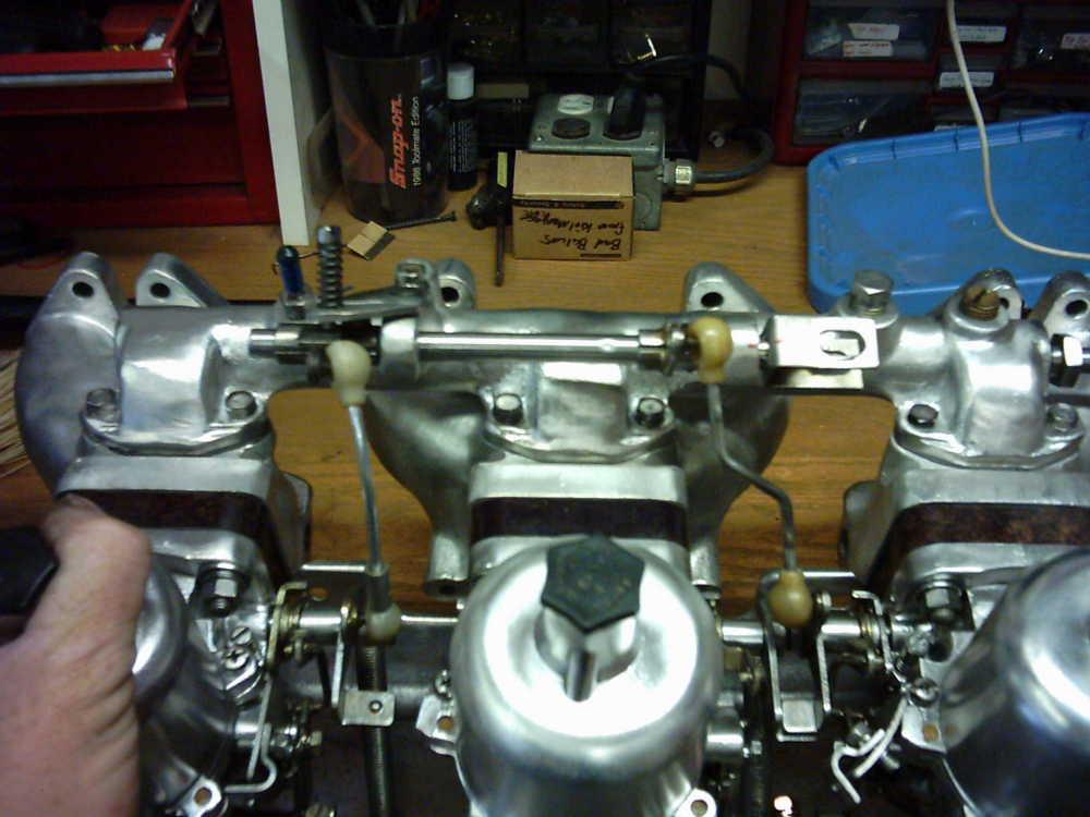

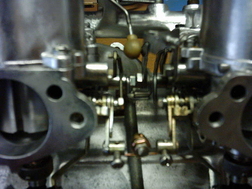

Had to make my own linkage, throttle and choke assemblies to make it work together. Fun stuff
