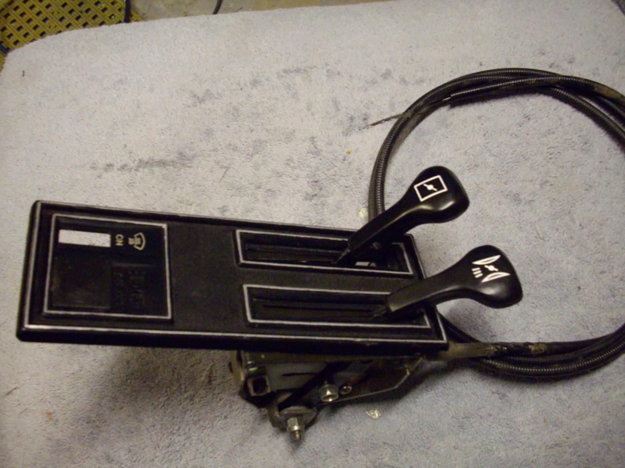

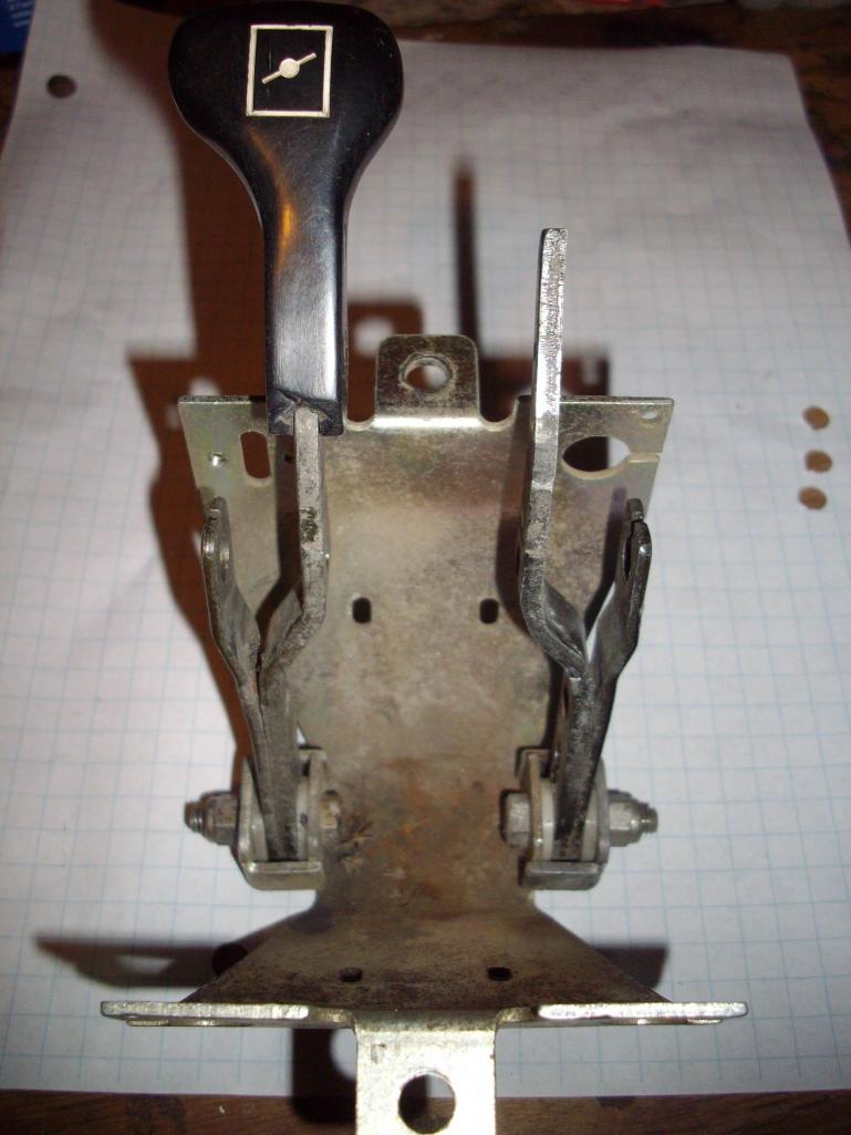

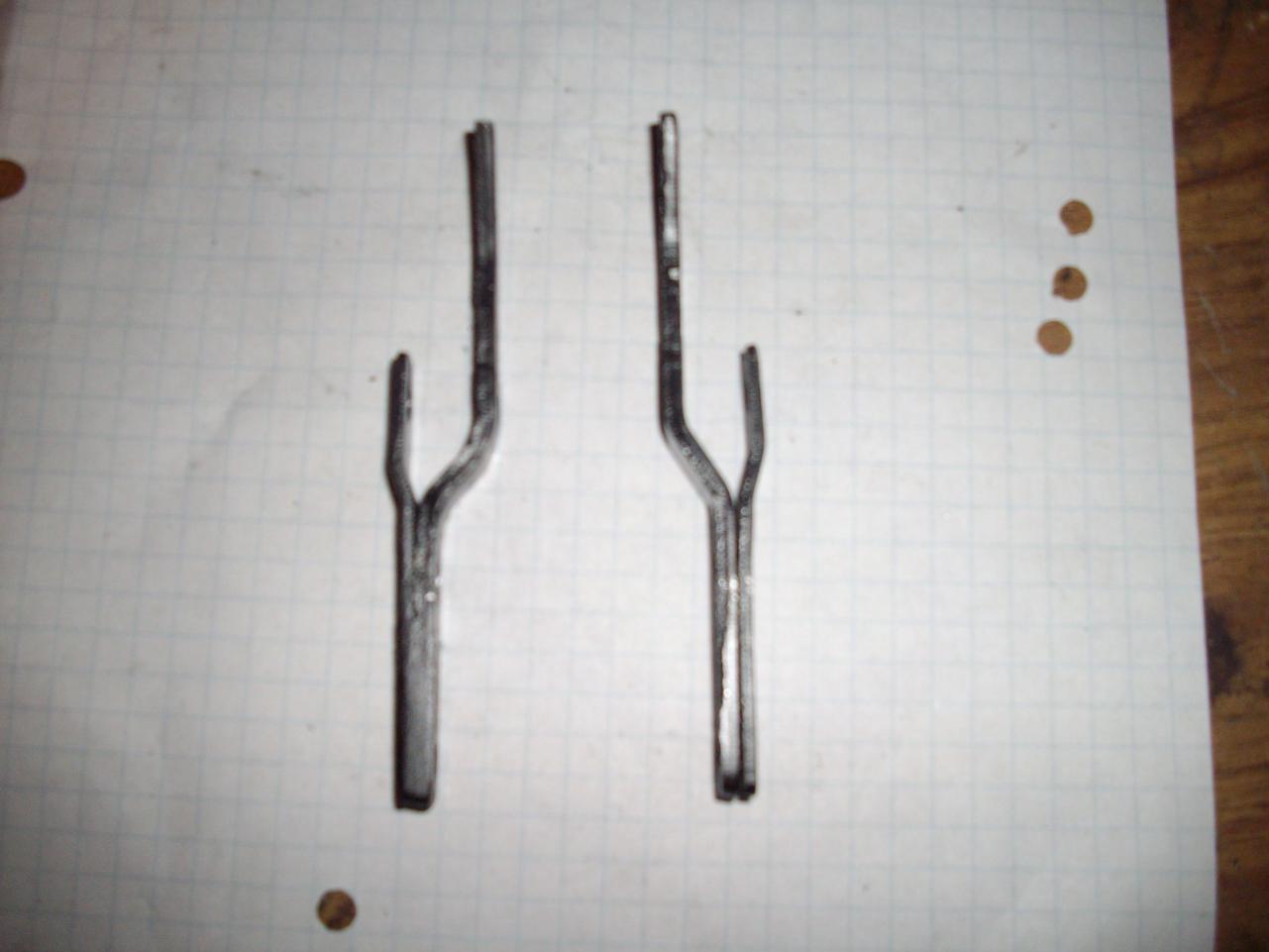

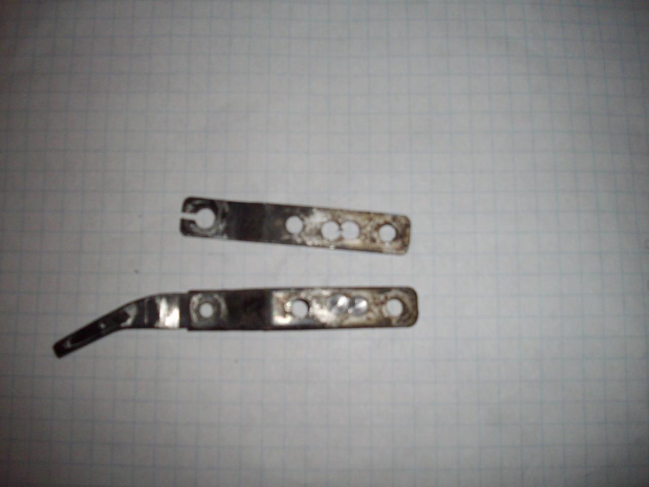

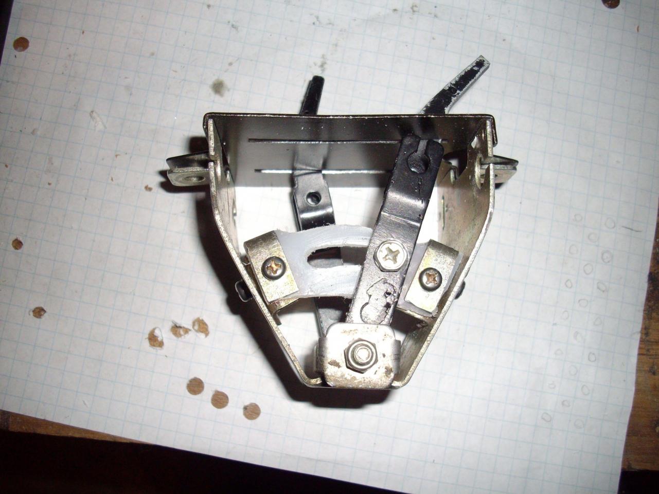

As it has been much too cold here to work in the garage I thought I would try to see if I could modify one of my spare choke levers to make it a throttle lever. as the lever is make from mild steel, I drilled out the spot welds and flattened it in a vise. After bending it to be the mirror image of the original lever I welded it back together. I than made a couple of brackets and a guide for it. As I was looking for something to fill in the slot, I think this will work very well. Now I need a better long slot choke/throttle bezel as the PO cut out a larger hole for an antenna up/down switch in the one I have now.

The reproduction knobs arrived today. I am quite pleased with them. Now I have to find a better bezel.

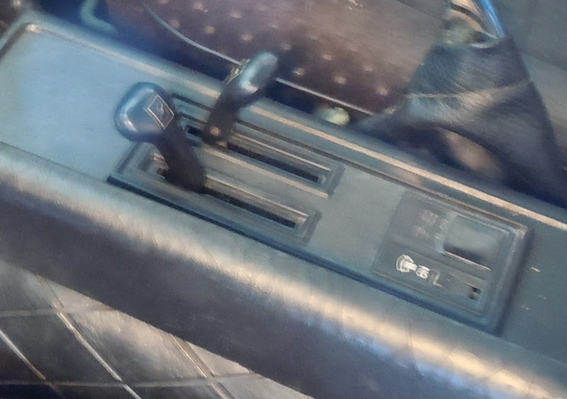

I've got an original setup in my 11/70 240Z. It does get a lot of attention from Z fans. This was eliminated early on because too many were using this as a 'cruise control'. Many that did found out the hard way that bad s**t happens fast when you forget to shove that lever forward in an emergency braking situation. For those not in the know this lever is a fast idle control. It allows the driver to ramp up the rpm's at idle so the fuel enrichment level (commonly misrepresented as a choke) can be disengaged. This allows the cold engine to warm up more quickly without running it excessively rich, fouling plugs, etc.

I have a 2/70 and it didn't get to me with the hand throttle, that's for sure. However, we did put one in last Fall, and like someone already mentioned, it works great as a cruise control - when the road is flat. We too took an old choke assembly and flipped it around. Fortunately the car had the requisite mounting bracket up on the firewall. Our solution to installing the knob was... well, rather elementary...
