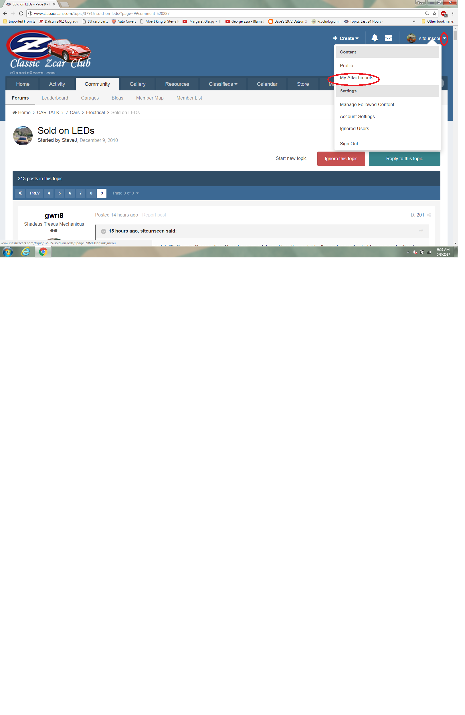

5 minutes ago, SteveJ said:
I'll try to remember to take some new ones of mine. I think I may have some posted in other threads, but there doesn't seem to be anything in the User CP to let me see the files I've uploaded for posts. I think one version of the software we had allowed me to do that.
This is how I do it or the "insert other media" button
