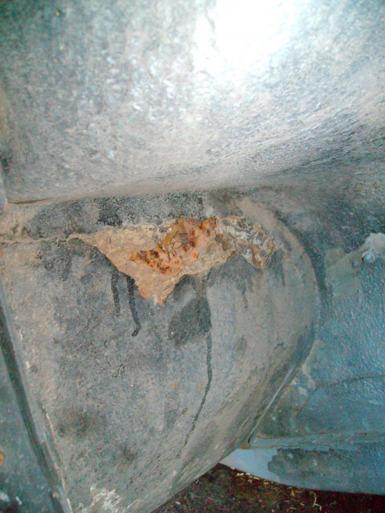

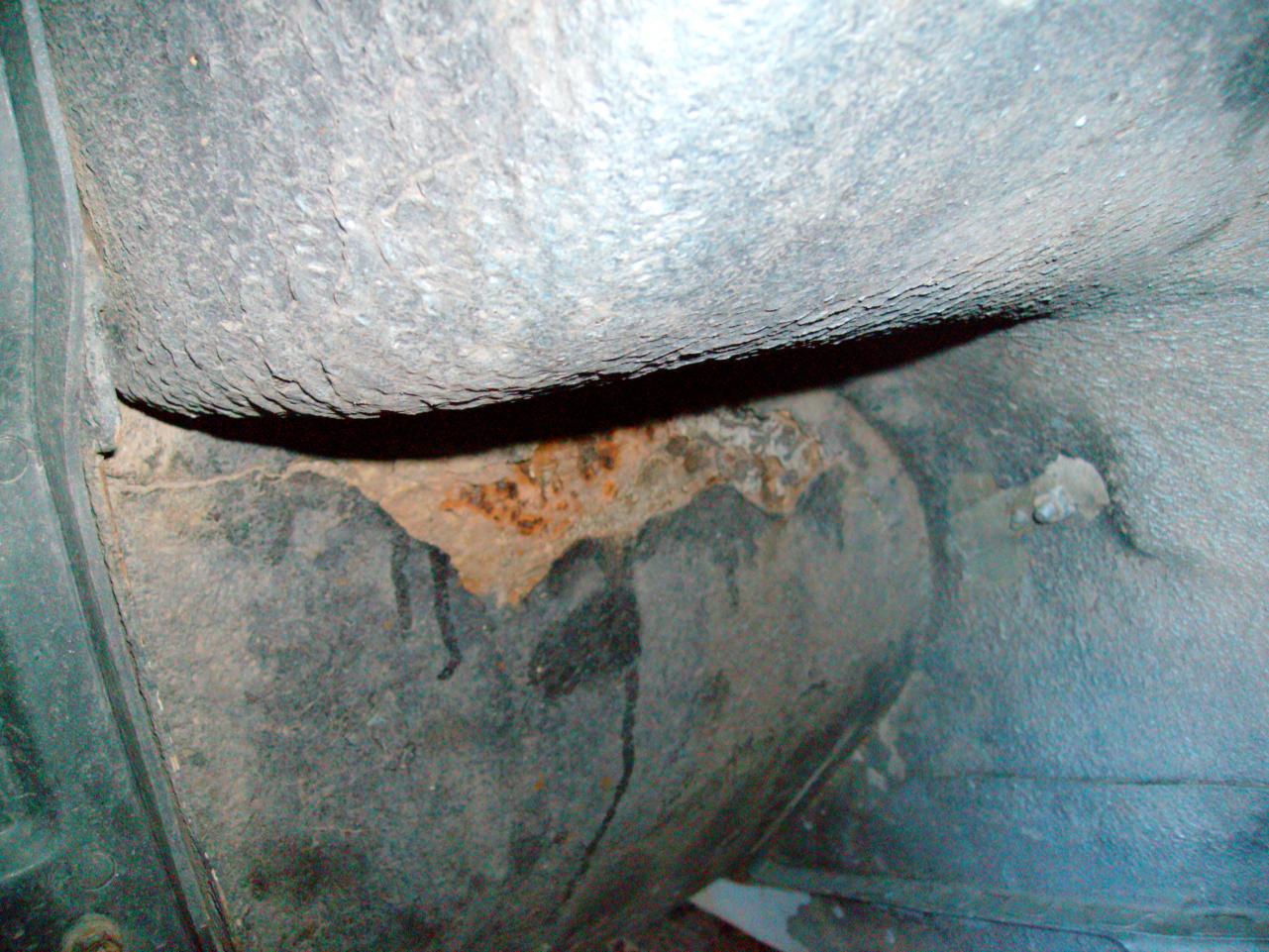

This was what it looked liked when I bought the car. Back then it was still sturdy enough to hold the water away. Now the middle of the rust is pretty much non existent and water just pours straight in.

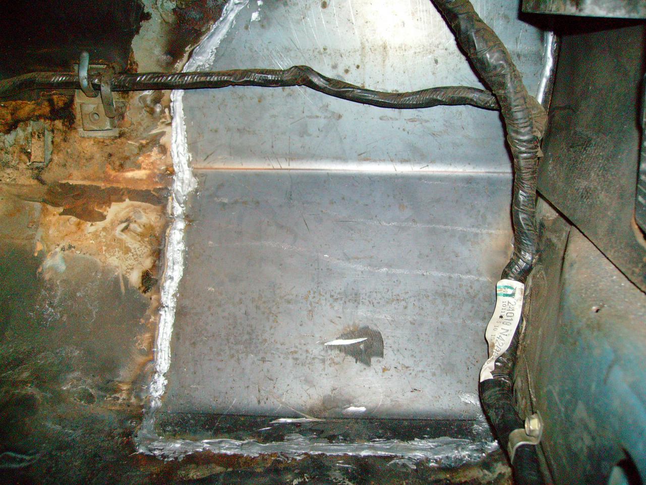

Battery acid got between the firewall and the right engine compartment weld up point. Very common rust spot. Lots of examples in the photo section of how to do this from squared out sheet metal to full on transplants. Search "battery tray" in the photo section. To fix yours, I'd get some of the firewall metal and some of the battery tray metal cut out and repaired, not just the firewall...
Right side drive...
Here is mine, I was lucky, surface rust...
My favorite is Diseazed' transplant of the left side of the engine compartment. :cool: Probably not what you are looking for...
Right side drive...
Did you use just some spare sheet metal or did you actually buy a floor pan and cut it. If you did use metal what gauge is it?
