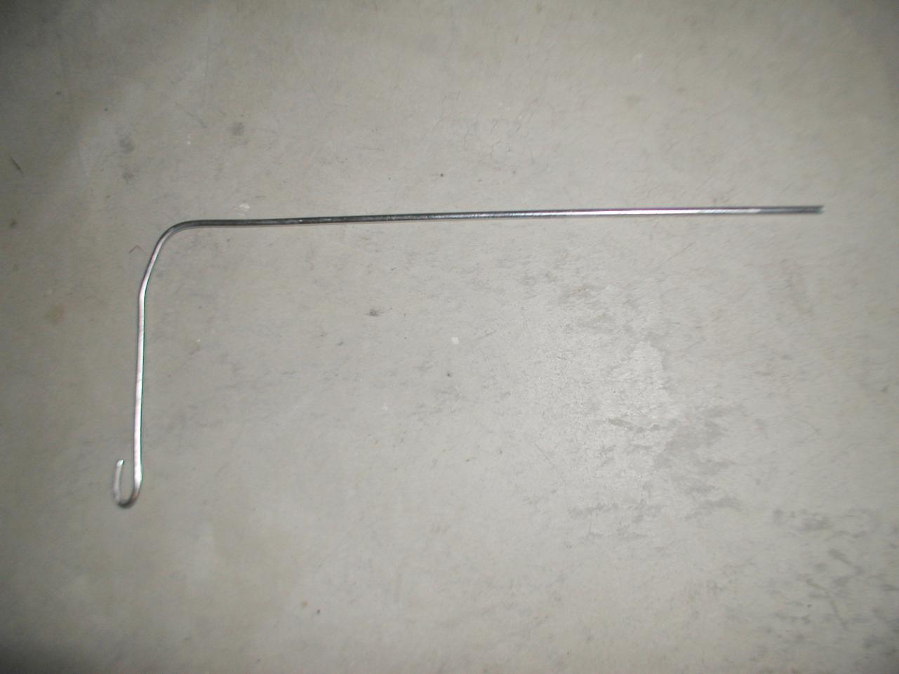

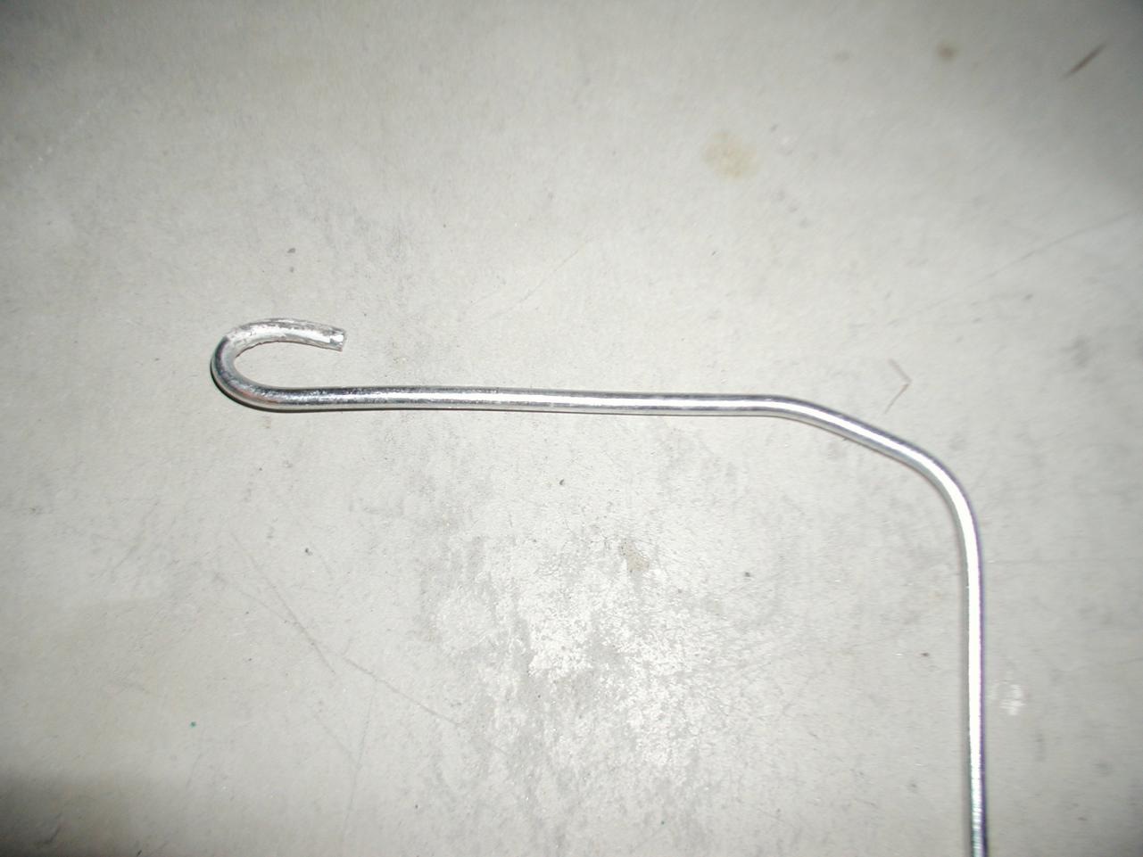

Hello all, I thought of resurrecting this old post since I was succsful in opening my front hood after my pull cable broke. The sketch post #9 is excellent as I bought a 5/16" diameter piece of a 3 foot long soft metal stock at Home Depot (~$5.00). It may have been aluminum becuase it bent pretty well in my hand vise. I bent it such that it had a 1" loop and an 8"-9" short leg with almost a 2ft long leg. See my photos....
Jacked the car up, and from the driver side close to the firewall, I placed this Loop into the wedge where the cable pull lever is. You have to feel for it a bit as it's 1" away from the firewall and 1/2" below the top part of the wedge holding the hood. It doesn't take much to push it outward toward the driver side of the car... and it popped the hood easily. The longest part of the job was jacking the car up and removing the Driver side front wheel.
I have rigged up a temporary pull line until I get a new hood latch cable from MSA.
Hope this gives others confidence on how to open the hood when the cable is broken WITHOUT pulling the hood off!
