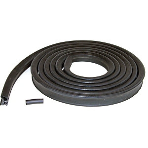

Do you know what the seal for the hatch is like?  It looks like it might be one large piece, like the Zed has.
JC Whitney has it, but the description says it's a "universal fit."  But one of the detail photos shows the cross setion, which resembles the KIA product.
This is the part number for the Sportage Lift Gate weatherstrip.  0K2B162761A
They do have a photo which shows the cross section of the part, and it looks like the KIA stuff:
