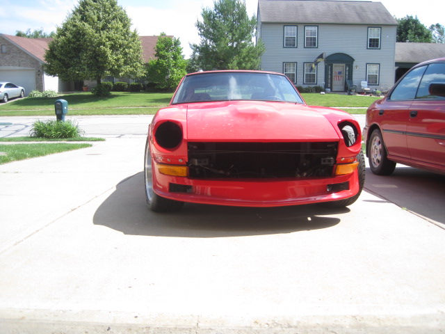

Although it was only about a block, but it did move under it's own power instead of me pushing it around on dollies. Did I say this thing is LOUD-like hide the women and children loud.
It did really feel SOLID going down the road and i couldn't hear any strange noises coming from anywhere -because it's so freakin LOUD. I will try and post a video this week.

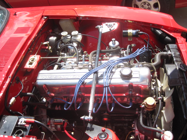

I have to do some double checking but I believe I will be ordering some magnaflows this week. They actually make something small enough for my cramped space. It took so long to get the pipes to sit right in the rear valance and i will have to start all over again:cry: Oh well, I only wasted 25$ on Both glasspacks, so i'm not out a bunch of $$$.

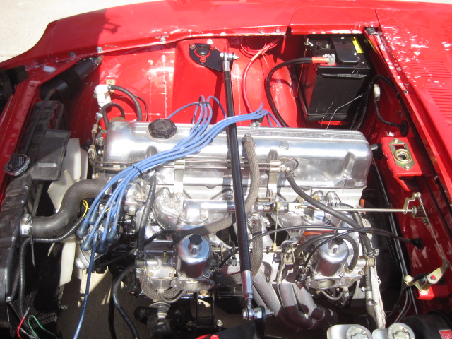

Well i'm stilling making headway, but it seems to be an hour at a time. The clock is ticking in the back of my mind constantly and reminding me to stay on task. The engine compartment is about complete except for tying up some loose ends with the headlight wiring. I am waiting on my airbox to get back from the powder coater. I have given up on having the triple Mikunis on the car before I go, I'm just going to run out of time.
The wiring i still giving me fits, but I expected that. I am going from automatic trans to manual, plus retro fitting some newer model stuff on the car which adds to the mess. I can't get my dash lights to work and i am getting a headache from staring at the schematic. I do have all my exterior lights working, including reverse lights and turn signals.

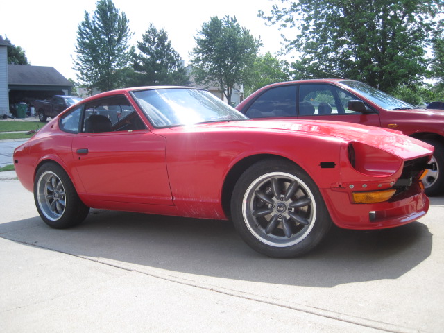

I got my spoiler buffed out and mounted up, so now she is looking pretty good. I still have to wet sand and buff out the entire car.
I have a weeks vacation at the end of the month and i'm hoping to have things looking better by then-if not- I might have to consider not making it in time-but I'm keeping my hopes up.
