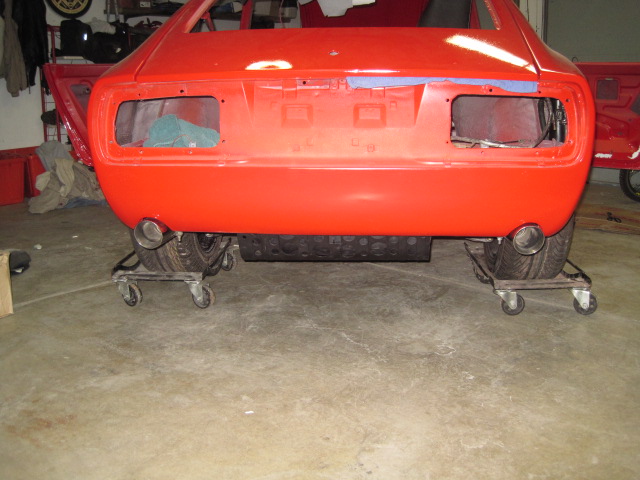

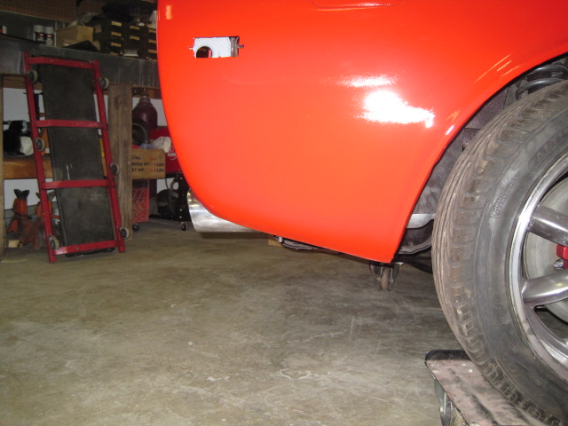

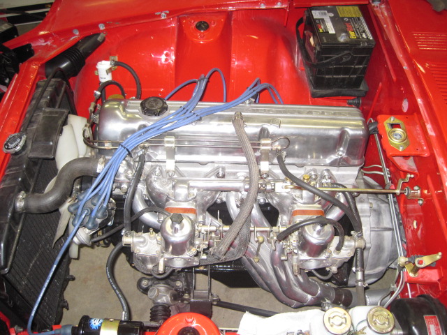

Well I had to search to find this thread I started because it was so long ago and that scares me. Zcon seemed pretty far away in January, but as usual time is flying by. I can't say that I am on schedule , but I am getting some things done. The exhaust is finally done, or as done as i am going to get. I bit off a pretty bite trying to make duals for this car. There isn't a lot of rom to work with and this was the first exhaust i ever fabricated. The hard part was making it look symetrical. The lack of room underneath only allows for short mufflers(glasspacks in my case) and it was hard to have them not at some kind of angle. Multiply that by the fact that I put an LSD in and had to fab a support bracket for the rear control arms which got in the way of the original exhaust-sssooooo more fabrication and moving of the exhaust. I ended up with exhaust tips that came out of the rear at a slight angle(down and outward). I'm willing to live with it after seeing a 370z exhaust tips that come out at a downward angle also. Sometimes you just have to say "good enough". I also started putting some of the interior back together. As you know with these cars that everything kind of starts at the headliner when you put a stripped out car back together. Well my headliner i put in was not up to snuff so I am redoing it. The padding I used was too thin and left gaps around the top edges of the headliner-so I pressed on with other items that i could do until more headliner material came in.

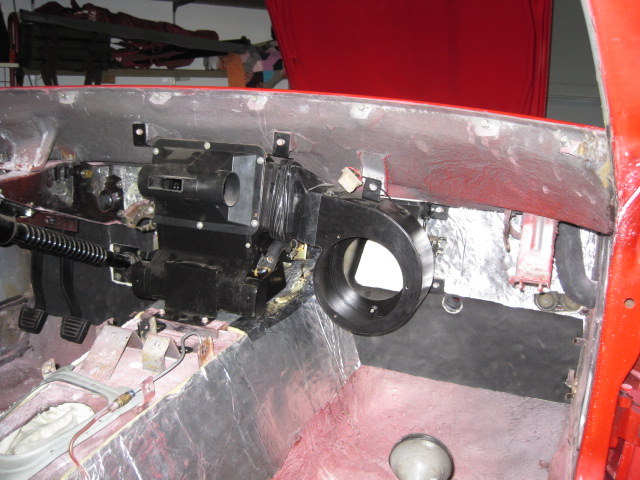

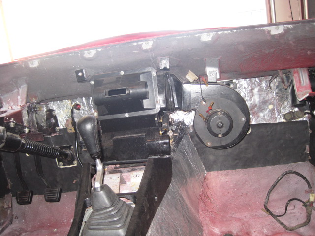

I installed some firewall insulation from some aircraft stuff a buddy gave me and then I was able to install the heater box which i had already restored. I then moved on to installing my gear shifter and boots. This might seem to be an easy job, but once again I was dealing with a change i made from stock. I installed the BWT-5 and that moved the shifter way foward and I updated the actual shifter which affected how the original rubber boots fit. So basically I took an one hour job and made it a 5 hour job because of my modification. I had to notch the console that wasn't the original console. My hats off to folks that work in the R&D department:)

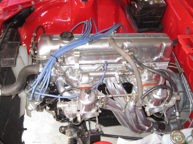

Lastly I worked on getting the accessories on my engine. All this while I was putting floors in another Z.

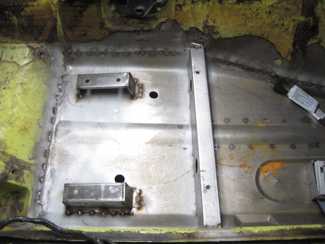

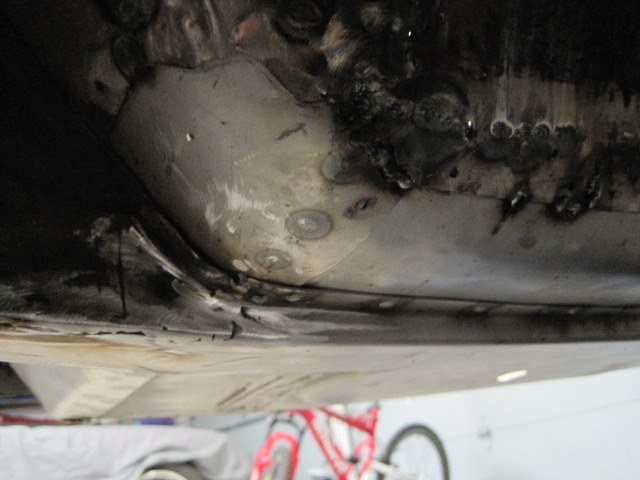

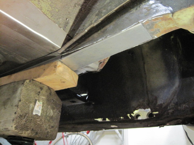

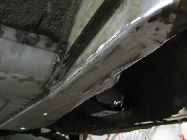

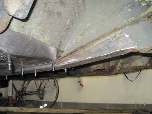

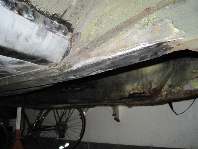

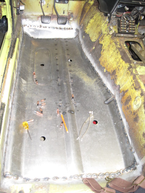

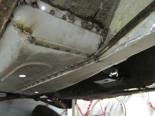

I see that you have finished welding in the floor pans. Looks great to me! :)Your posts here and at Hybridz have inspired me to order a set of pans from Charley Osbourne and I am getting ready to order a set of Baddog rails.
Take care of yourself - you have a lot on your plate! Been there back in '95 trying to make a meet with '57 Chrysler 300C and have the heart attack(1st one) to prove it.:stupid:
Be advised that those floors are like most aftermarket panels-they need lots of work to fit. I posted on HybridZ about the floor pans , but recieved no responses. I feel that the pans are made too deep(compared to my untouched car), which causes a problem lining up with the floor support. No easy way to fix that unless you want to reform the floors on the outboard side. Then again, I repaired a Porsche 911 floors and those panels weren't that great either.

Floors aren't too bad since no one really see them if you do a terrible looking job:D I tried to make these look stock appearing from the outside. I also strived to do as much of the welding as I could outside the car or from on top of the panel. Anyone considering this job should order about 20 clecos from Summit or somewhere. They are a great tool for doing this kind of repair and they are cheap. I probably have 50 hours in the floors which include the floor supports and tying into the tension rod boxes to repair the bottom side of those.
I still have rockers, doglegs, and hatch sill plate and a couple of other small items to finish on this customers car while i'm trying to finish mine in time for Zcon. When I get tired of doing the noisy, dirty work on this car i go and do some clean work on mine to keep my sanity. Actaully I think I like the dirty work as much!

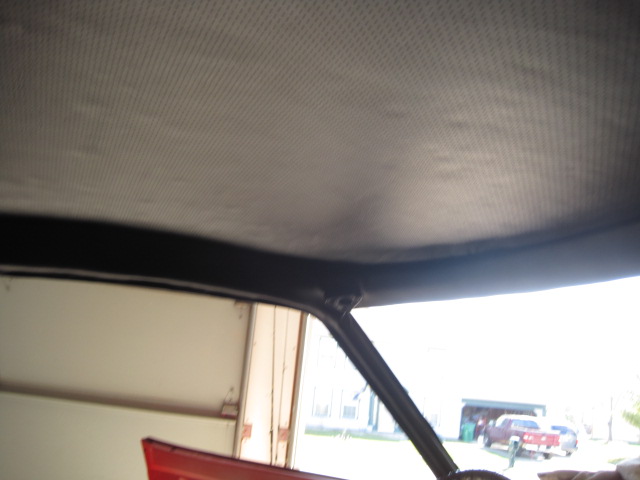

My headliner material came in today, so i know what my next major project is now! because after that job, everything should feel down hill.
  • 3 weeks later...

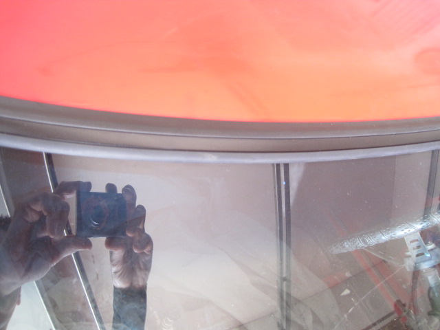

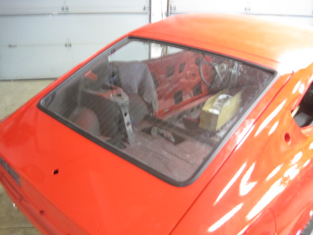

I try not to watch the calendar, but it is only 4 months away and I have lots to do. I have made some major progress in that I got my headliner in, which was holding back from completing many other jobs. The front windshield also went in with little trouble, though I nicked the seal slightly installing the trim. I had my trim powder coated matte black like everything else that is trim ,and I am happy with the look.
The rear hatch was a bi$%h and it took three of us to persuade it to settle in. Again I suffered a nick installing the trim, it was even tougher on the rear hatch. I also got some tears on the inner part of the seal, but no one will see them and it shouldn't affect the sealing of the window.

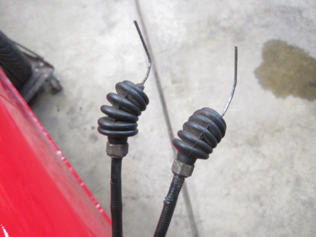

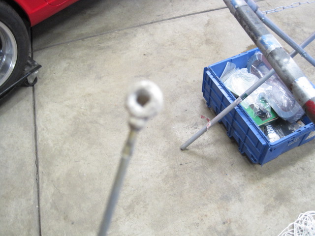

I also got some needed items from the plater, but once again there are issues. The acid or whatever they used ate up some off the nylon pieces. I was told by the plater that the "plastic "should be fine, but this stuff is nylon I guess. Anyone else have this issue? The ball end on one of the carb linkages looks really bad, but I can't remove that end since it is pressed on or something. So maybe I can replace that end or see if they can plate another one without dipping that nylon ball.
Questions: Is the door latch assembly supposed to be yellow zinc like everything else? Mine are very clean, but it doesn't look like it everhad any "yellow" to it.
How do you install a new choke grommet on a set of choke cables?

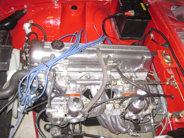

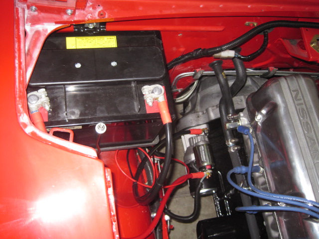

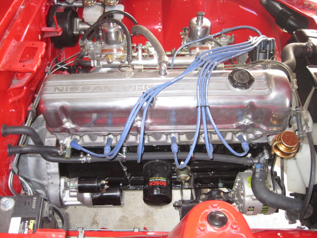

Well this is a big step towards Zcon. After having this engine together for the past 3 years, I finally get to start it up. I finally got my battery cable ends in to make my custom battery cables so i could use the factory cover. I am glad I did it, because these cables are much better then anything I could find at the parts stores.

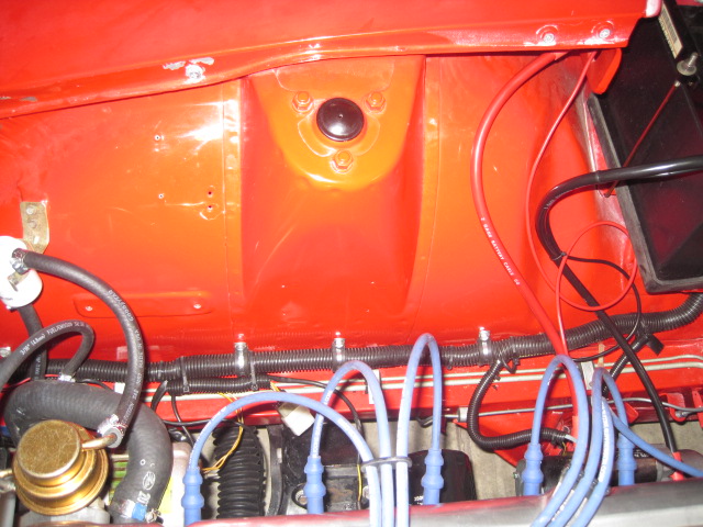

After i got my timing issue resolved, it fires up right away, but it is freakin LOUD. I might have to rethuink the glass packs on my duals. It's going to sound loud sitting in the garage, but I think it will be too loud for a daily cruiser. I was glad to see all my guages were working except the fuel guage, but I expected that. Even the tach works after doing the zx dizzy mod. I guess my alternator I bought off of ebay is a dud, never again will I buy an item like that from ebay. What's sad is that it was a Z forum member that sold it. I should have another alternator by this evening, which should help the car run even better--- instead of straight off the battery. I also noticed when the car was running that the temp probably only got to 160 at best, but I might have put a 160 thermostat in.
Now I need to finish up running the harness around the engine bay and work on my headlight relays. Then I can bleed the brakes and take this thing for a spin:D
