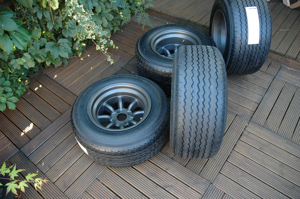

Here are some ( 15 inch ) that I've had on the GT-R:

Take a look at the photo I posted. Do those tyres look stretched to the extreme - or indeed dangerous - to you? The rim widths there are 9.5j and 11j, and the tyres fitted are not as wide as the 'approved' sizes......
