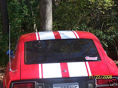

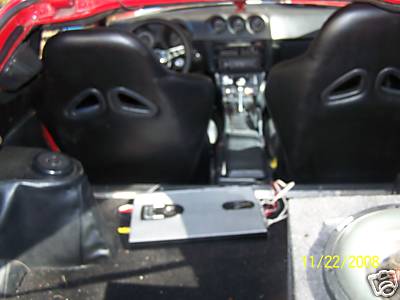

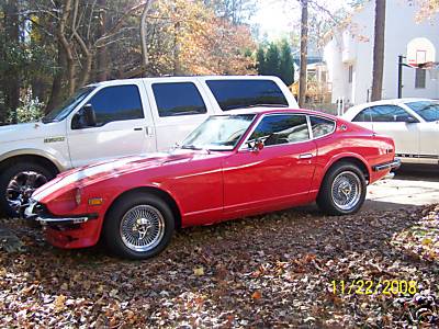

The pics are fuzzy, but doesn't it have a whole lot of 280Z parts on it? The dash, console, door panels, hood, hatch, tail light panel, etc. are from a 280. I can't see the front turn signals in any of the pics, but they might be from a 280 as well. Also, unless the camera is playing tricks, there is something going on with the stripes. They look very crooked from the back.
The engine bay VIN and inspection lamps are located in 240Z position, but it looks like there are 280 parts there as well. Did the '71 have a vacuum canister there? What about the radiator support to fender ducts? Are they on the '71s?

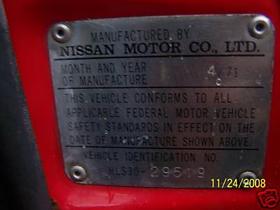

Looks like a 260Z with the door tag from a '71 240Z to me. I'd want to see the other VIN locations prior to bidding. Could be a nightmare to title or register outside of Georgia. In Oregon, for example, to title a car from out of state, the car must be inspected by the DMV in person and all known VIN locations must match. I suspect other states may be similar.

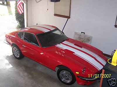

Look where the door closure is, the type, It look like mine and I have a 280. Also the dash looks like a 280. Looks like 2 pictures are not from the same time period, the car in the garage from 11/01/2007 and the Vin tag from 11/24/08 all the others are from 11/22/08. Why the different picture times.
Looks like someone bought this '71 280Z ;) I thought the same thing, and either a) someone took the VIN tags from a '71 240Z and stuck them on this 280Z, or B) someone stuck a whole bunch of 280Z parts on this '71 240Z shell. Most likely (a) in my opinion. I did ask the seller for a photo of the etched serial number on the firewall (I believe 280Z's have this as well?) to see if it matched the VIN tags. He ignored the request.

After doing a little surfing on Cardomain, I agree with Arne. The '71 240Z is actually an early '74 260Z. Everything I originally thought looked like 280Z parts are really 260Z parts. The inspection lamp, VIN tag, vacuum reservoir, radiator, dash, door panels, tail lights, etc. all fit 260Z designs. I would say that there was some VIN swapping going on. I wonder what he did about the stamped firewall VIN? :finger:

Those bumpers and the tail lights just look more like those from a 260z. Could it be a later year 240 like a 73?
Only if the tail lights were swapped from a later car. All 240z's have the integrated white backup lights. All US 260 and 280z's have the separate white backup light closer to the license plate. Swapping out the rear panel is a whole lot more work than swapping the VIN tag which is what I suspect happened here.

My guess....it's an early 260Z with VIN plates from a 240Z.
