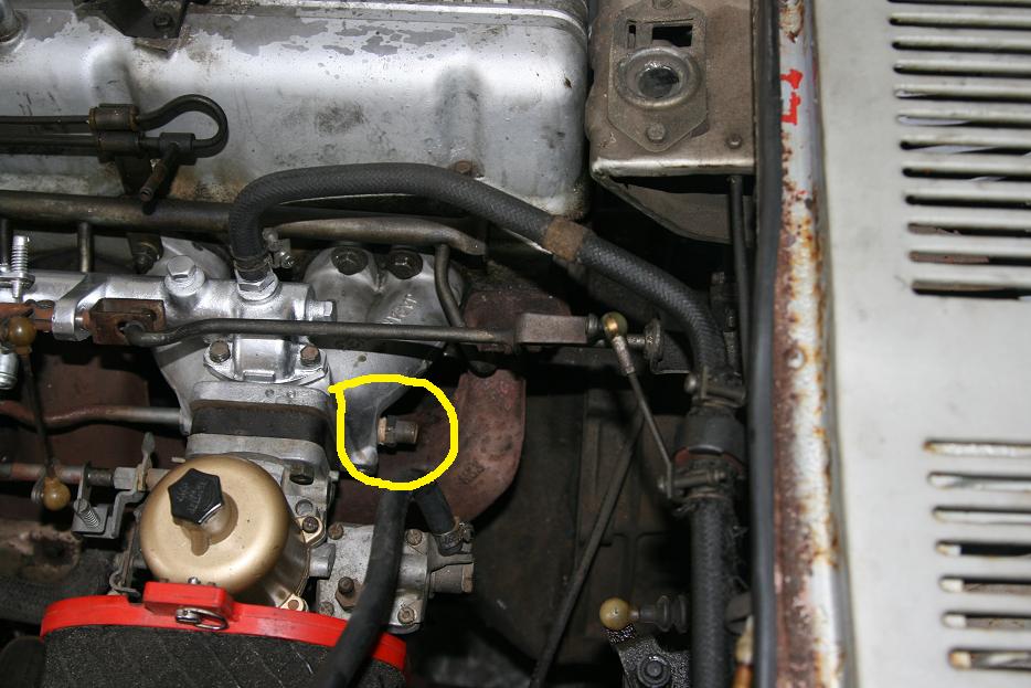

I just got the new carbs and intake bolted up. Since I've moved from the 1973 version to the 1971 hear are my questions:

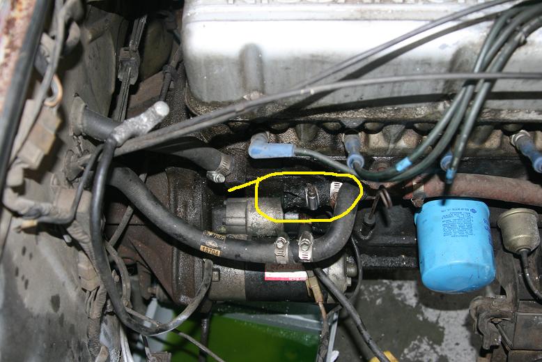

1. Can I replace the metal or copper tube that would not mate up with a piece of hose? The original was metal or copper and ran around to the other side of the engine and into another fitting, does it have to be replaced with metal or copper or will hose or line work. When I removed it alot of antifreeze drained out. Please see picture's with Yellow circle's.

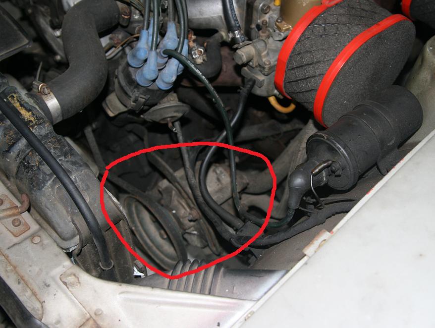

2. Since there are soooo many extra pieces left over I am assuming I can just remove all this crap. There is a pulley and various hoses. Please see picture with Red circle.
I'm using my 71 as a refrence, and it does not have all these extra "parts" but wanted to make sure it wouldn't affect anything.

My 73 has a 72 carb setup on it. It has a fitting similar to yours coming off the manifold except it is longer and has a hose connected to it.The other end has a short hose connected to a bent pipe that comes around the back and connects to the front hose, so you need to have something there. My smog pump is gone.
If you look in my photobucket pics under "engine before pulling" you can see the pass. side of the setup
Edited by tibZ
The tubing and piping to the carbs is for manifold warming, felt to help with cold start and (IIRC) may improve emissions by shortening the amount of time the engine has to run richened by the choke. The "pulley" and its hoses are emissions equipment that can be removed, but should be blocked off at the manifold/balance tube to prevent vacuum leaks.
The second pic shows a branchpoint where water is diverted behind the block to warm the intake manifold via the tube in the first pic. You can disconnect it from running to the intake, but don't plug it completely or it'll cause problems running water to your heater.

Sorry, I'm away from home so this is mostly from memory....If you re-plumb the pipes to/through the intake, IIRC you also have to reconnect it to the thermostat housing, so confirm you have the correct housing first. I would suggest not connecting it, and just keep the heater hoses connected as you have it currently. I have a similar setup (N36 intake) on my L28 which is not warmed, and I have no cold start issues.
The coolant was meant to go through the intake manifold for BOTH heating and cooling . The Z club I belong to recently held a car show. And had a Dyno available to us to run our cars. I found it interesting that the Zs that had the water disconnected to the intake manifold had predetonation problem under power. I have the lines hooked up and had no trouble. I realize that driving on the road and on a dyno are two different things , but with the exhaust manifold only inches away , think about it before you re-engineer a proven method. Believe me after 35 years you are not the first one contemplating this change. I suppose if you live in a cool climate you could get away with it. But having the coolant going through the intake does NOT effect the performance. Save your old air pump. In the event that you have to test for emissions , Just the core charge is $200.00 for one of these.

How you doing? Long time since we've said hello. I'd go with reconnecting it. I don't see any problem with using heater hose to connect it, but I'd fabricate some pipe to go from around the fitting on the passenger side of the engine to come around to the fitting and then put only a short piece between the pipe and the fitting on the intake manifold. That's the way, it was orginally done. I'd send you a picture, but my Z is in storage right now:disappoin
As far as the pump, we need to see what else you've left on the manifold in the way of pollution gear. Yes, you can take it off (I'd recommend it), but be sure to block off the air gallery pipe at the check valve. I noticed you left the fresh air gallery pipe attached to your exhaust manifold. If you haven't tightened everything up, I'd get rid of that too. If not, just leave it, but be sure not to just leave the check valve sitting there with no positive pressure. It will corrode and start leaking eventually. PM me if you need further help.
