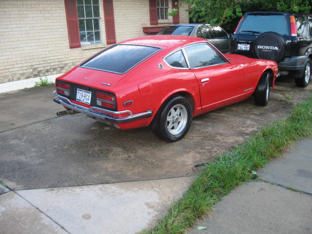

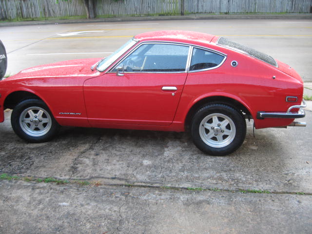

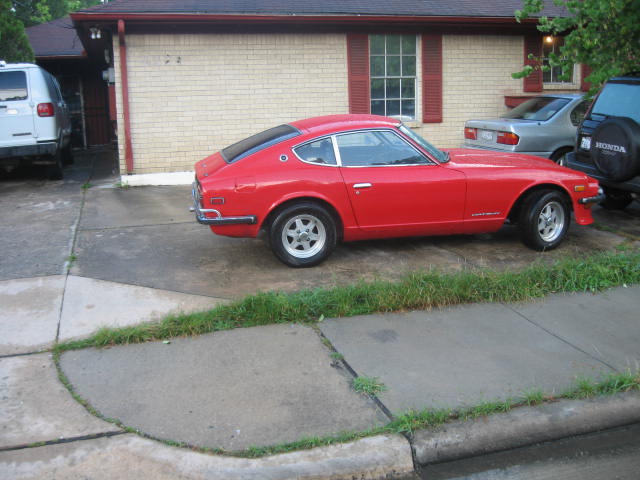

Finished with the replacement of the springs and struts. I have included some pics. The ride is right, but it is a bit taller than I wanted. I will probably have to cut some length off the springs or put back my stock springs, but all in all I am happy with the result.

I don't think it looks bad, but I agree that the car's stance would look better if it was dropped an inch or so.
When I installed my Tokicos, at first the car looked like yours (I was using stock springs before). Lowering springs equals a higher ride height...? Huh? Turns out they just needed to settle in. Now I'm at roughly the same height that I was at before, it's just that the old springs were sagging badly so I was at the 'lowered' height already....
You'll be happy with those new springs. Your car is going to handle very nicely with those installed.
How long did it take for your springs to settle in (time or mileage)?
I've heard everything from 'drive it around the block' to 'drive it for two weeks to let the springs settle'. Mine looked like they were pretty much settled in after driving it to the office and back.
