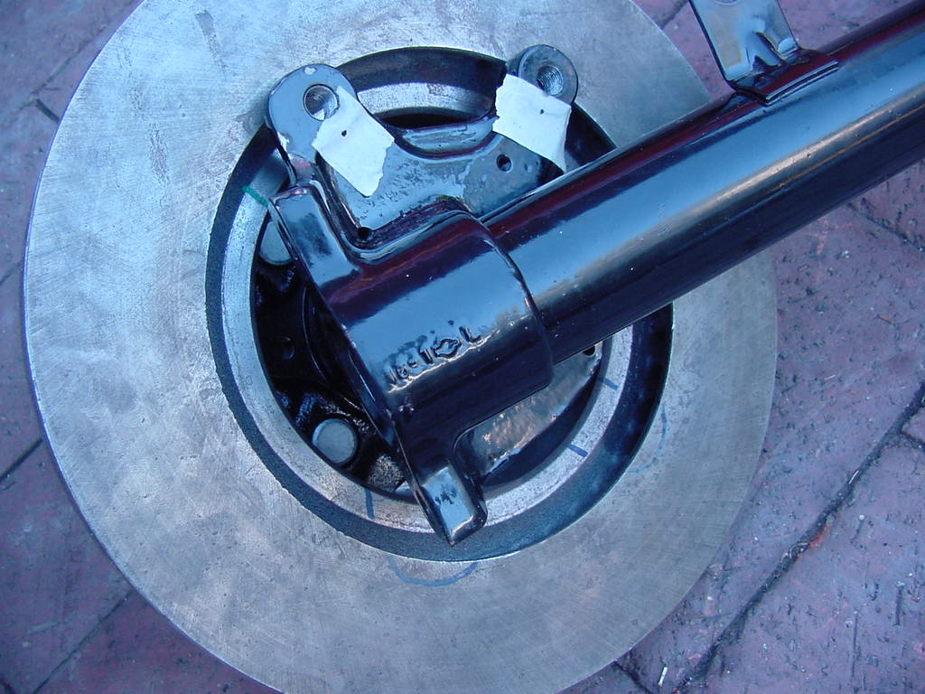

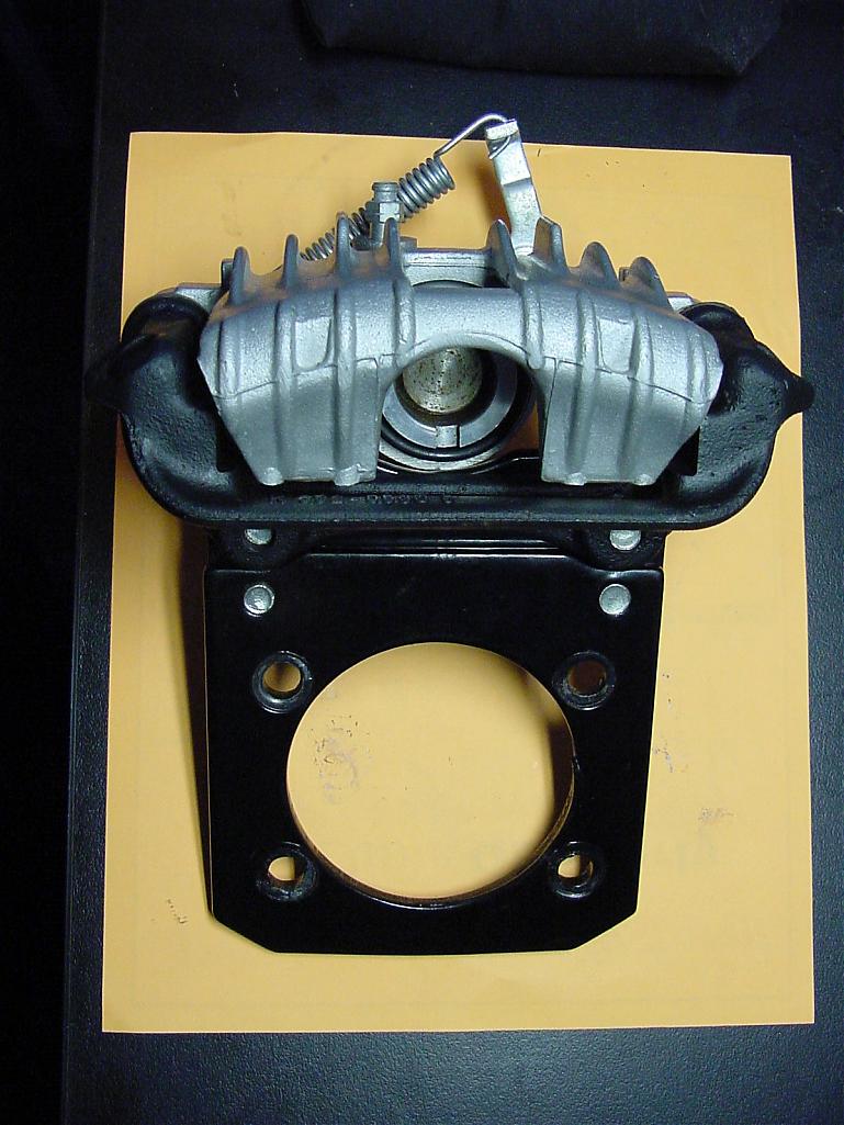

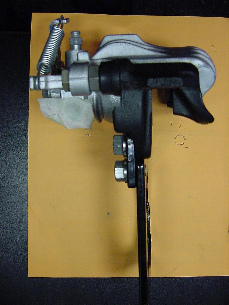

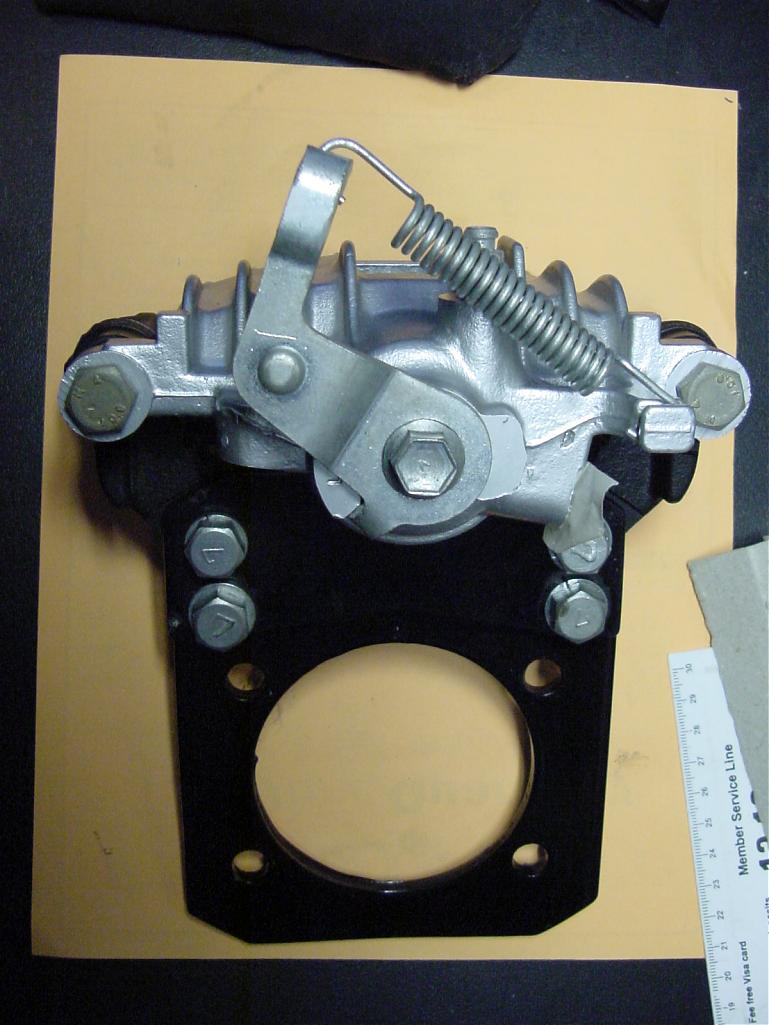

I realise that this hardware may not be available to you in the States but, in Oz, a cheap, easy and effective rear disc conversion is done using the R31 Skyline callipers and rotors.
I have posted a heap of pics. about this on the following Sony Imagestation site: -
www.imagestation.com/album/pictures.html?id=4291183313
It is literally a bolton conversion, with minimum fuss:classic:
This hardware required is plentiful here so let me know if you are interested.

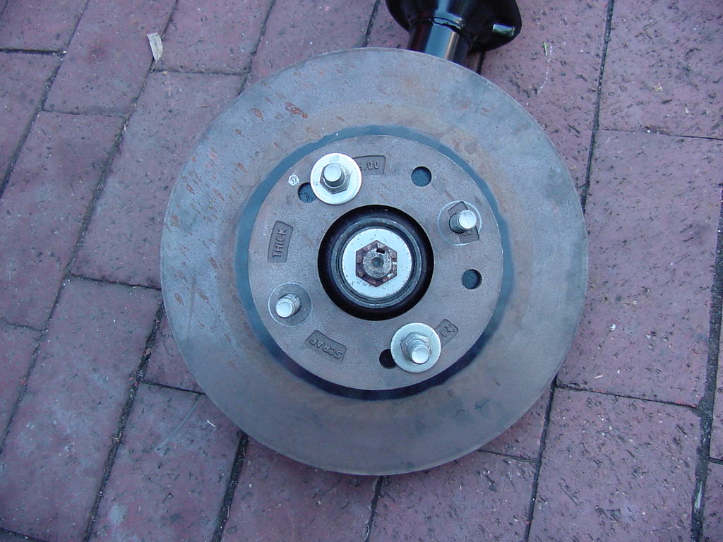

From your profile I can't determine where you are from but, the fronts are planned to be ex-Commodore vented rotors with matching callipers.
These bits go for a song when the factory upgrade a car to HSV specs.
The brakes aren't new but they are hardly used when the car is driven from the factory line to the HSV workshop!
The rotors (296 x 28mm) have been re-drilled for the 4 x 114.3 PCD and therefore are now "rotor over" as opposed to the stock "rotor under" design. Wheel studs have been replaced with 60mm Nismo items to cope with the additional 10mm thickness of the rotor. The callipers will need re-drilling to match the calliper mounting ears on the stock struts. They are twin piston alloy housings with a cast iron anchor.
Lots of pics. on my Imagestation: -
http://www.imagestation.com/album/pictures.html?id=4291183313
Here are a few teasers: -
