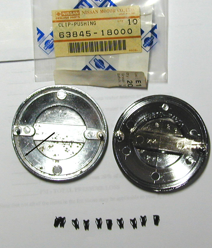

I apply it to both posts, then run a very thin bead around the inside of the groove around the outer edge (see arrow in the picture below). That way it seals the outer edges of the emblem to the surface of the hood and prevents the airflow from getting under the emblem. Once you push the emblem in place, if a little adhesive oozes out - you can clean it up with a Q-tip and some lacquer thinner.
In the picture below - the emblem on the Left is metal, the one on the Right is plastic and Nissan fasteners are below. While the Parts Catalogs show "Clip-Tublar".... the bag of them that I have on hand show "CLIP-PUSHING".... same part number nonetheless. These clips don't seem to be a problem when used on the emblems on the rear quarters.. I don't use them on the rear deck lid either.. mostly because they rust there as well as on the hood.
