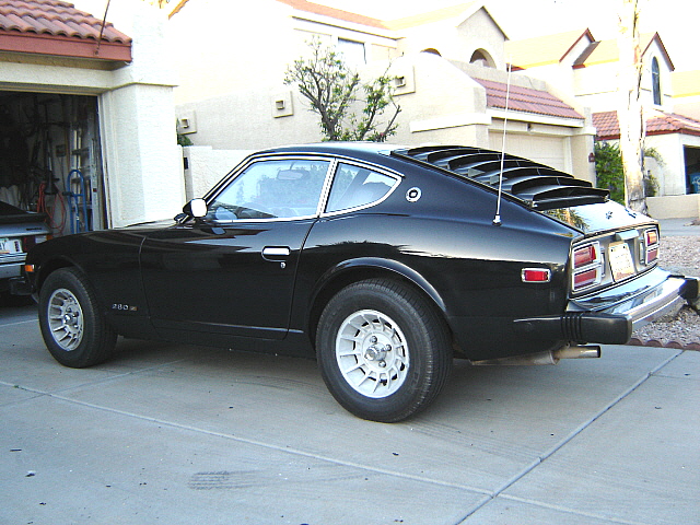

June 13, 200619 yr comment_170858 Here's a picture of my 280Z with 205-60-14's, the tires are Kelly Platinums. I'm satisfied with the ride, handling and the way it fills up the wheel-well. The springs on the car are stock/OE. Neither Costco or Discount Tire would let me go oversized on the tires because of the liability issue. Good luck with your decision. Link to comment https://www.classiczcars.com/forums/topic/20401-your-opinion-on-tires/#findComment-170858 Share on other sites More sharing options...
