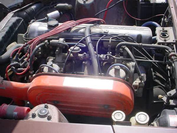

Hey Bill, I think those are Taylor Red 8mm on that beast. Still good wires though. MSD Blaster Coil also. Just looked at your pictures to refresh my memory and yep, they're definitely Taylor wires.
Chris
