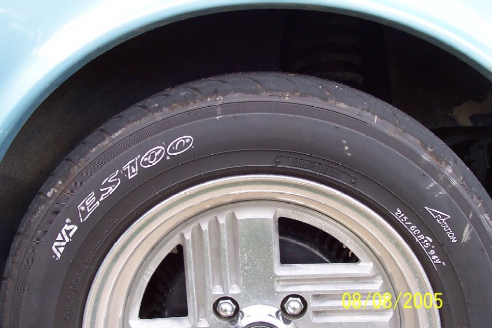

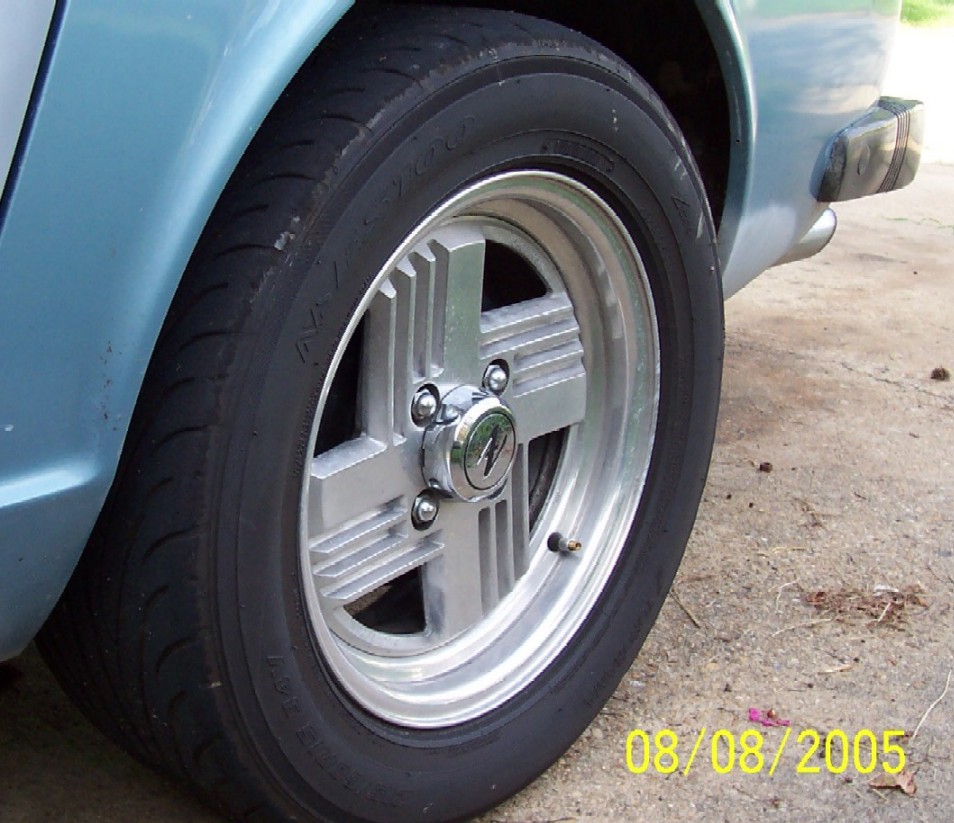

I like them. They came on the car as I bought it, I'm pretty sure I'll replace them with the same when needed. See attached pictures. Sorry I haven't cleaned them up, auto-crossing was yesterday and tonight is the club meeting. Maybe a quick bath at the corner car wash before the meeting.
Don't worry about the speedo, it's off anyways. :nervous:
Wayne
