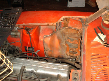

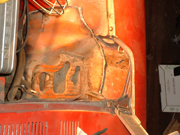

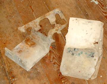

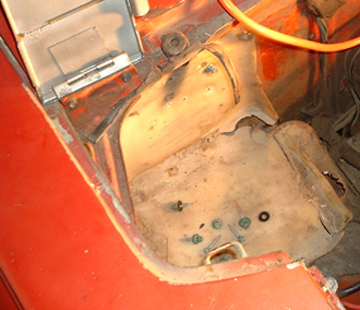

So, I drove the 3 hrs. to return Sat., and of course he hadn't left as much of the battery box as I wanted, but I think it will do to replace mine. Just very minor rust. It has to be better than the thick plastic dairy thing and chunk of 2x4 that had been screwed there before. I've included a couple photos with the PO's fix, as well as the removed contraption, and two pics with the repair section test fitted. I cut away all the really rusted area yesterday and found I have a bad rust thru in the firewall as well. Any suggestions, cut it all out and replace with a flat patch panel? Or is there a better way. I'll take photo of firewall tonight.

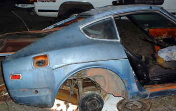

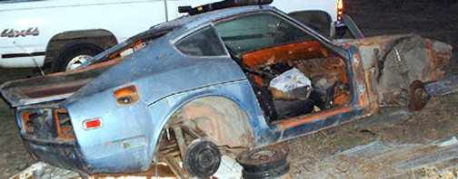

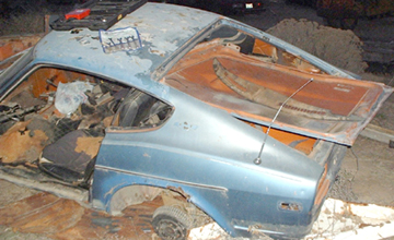

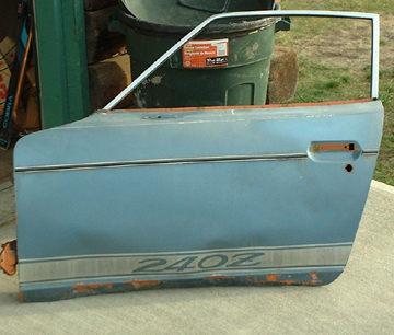

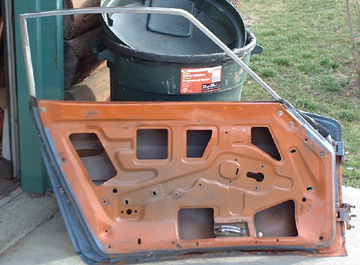

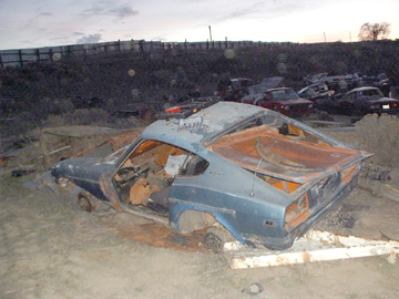

And here are some pics of the parts car, I also got the driver's door. It is dented at the bottom, but I've read here it is better to repair a dented, rust free door, then to try and fix a dent free, rusted door with a patch. Any other parts I should be looking at? The roof is kind of rough, no dents, but looks like it's starting to rust. The hood, stuffed in the hatch is really dented at the front point. The vented hatch was gone. The wrecking yard owner is cutting out around the tire well because it is perfect ($10) and he is getting me the uncracked windshield ($20). I could have had the whole car for $125, but just could not stand the idea of towing it for three hours and having another hulk in my back yard. My neighbors will start to complain. I don't know if the guy is up to cutting out both rear quarters. I'll have spent about $75 when I'm done, but I can sell some stuff to finance some more stuff.By the way, the car was originally orange. Mine is 905 red, but looks kinda orange in my cheap digital photos. Sad to see the state its in, but happy to know it will live on in my car.... eventually.... I hope.
Get the rear section-if it isn't rusty-that is a very common area to have to repair.
Get the seat mechanisms if they are early(round adjusters-not levers). Just store the mechanisms if you don't have room for the seats.
Check the vent area under the cowl and above the heater fan-they rust out and need repair(I need one).
What about the wiring harnesses?
There is one quarter window left!
Not necessarly the right way, but FWIW, this is how I did mine. Without any stamping or the roller kit from Eastwood, I used the panel off my donor. I just didn't want the 'flat look'.
I took the upper half of the firewall (from the donor car) where the battery mounts to as it was not rusted. I rotated it 180º so that the embossed sections matched up. see photo below~
If you are going to attempt this, I would highly suggest removing the spot welds that attach the firewall to the cowl in the area of 'donation.' I also had to weld in additional mat'l below the patch on the firewall due to cancer.

Both rear quarters looked in good shape, if the are grab them!
I'm thinking about making the three hour drive again soon, and will see if I can get this guy to cut both quarters off in back, maybe the roof section too. I have to go back for the windshield and tire well anyway. I wish I was better at doing this kind of thing. The outer wheel wells (lips, whatever they're called) are kind of rusty, but the rest of the quarters looks OK. I should just pay the $125 and tow it back, but what a PITA.

Thank you for the pictures. Yes, I was worried about the flat look myself, but may end up going that way. I'll check and see if my wrecker-find has a good firewall section to cut out. I went to where my friend had the hulk of my stripped '72 parts car stored and it looks like the firewall there isn't much better. I did retrieve the fender splash guards (another whatever they're called, couldn't find it in the FSM). They go behind the fender and are bolted on to the body with three bolts, have a rubber piece on the bottom. I believe these are to keep water, mud etc. from splashing up between fender and door. These were much nicer than the ones on my '71 car. Gary D.
