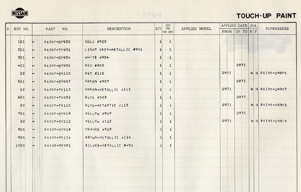

I'm hoping that this scan from the Nissan "R-DRIVE" parts lists for the RHD export market cars will be of use to you:

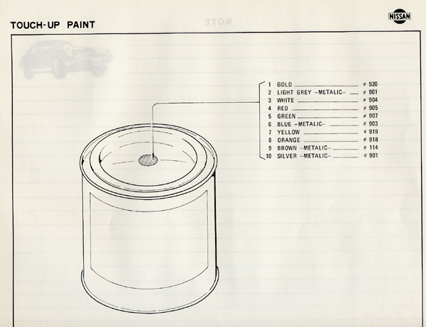

And here's the explanation of the applications of those colours:
Hi Alan,
Thanks for the additional info!! I hope I'm not going to get in over my head as I attempt to expand this list. I started with the US codes because it was fairly easy to steal them from zhome :), but from all of the reading I've done on this site I know that things really get complicated as you start looking at the full production history.
One question about the touch-up paint scan you posted. Should those apply to all RHD export markets (which I assume means GB and Oz/NZ) - and not necessarily apply to the domestic market (Japan)? Also I just took a second look at the application note - so I suppose the ones listed as "From 9/71" apply to the end of the 240Z production ('73 model), right?
Thanks again for the info and scans!! Looks like I've got a little more work to do.

Hi Michael,
Yes - the scans were from the "R-DRIVE" Nissan parts book that covered the period up to March 1973 by using additional update pages.
That particular book says that it covers all "HS30" models - with special notes on UK and Australian market applications. It also notes some applications and options as "Europe" and "Ex. Europe" ( meaning excluding Europe ) - but I would have thought this would indicate the European version of the HLS30, so I'm not entirely sure about those models.........
However, it does NOT cover the Japanese market models at all.
