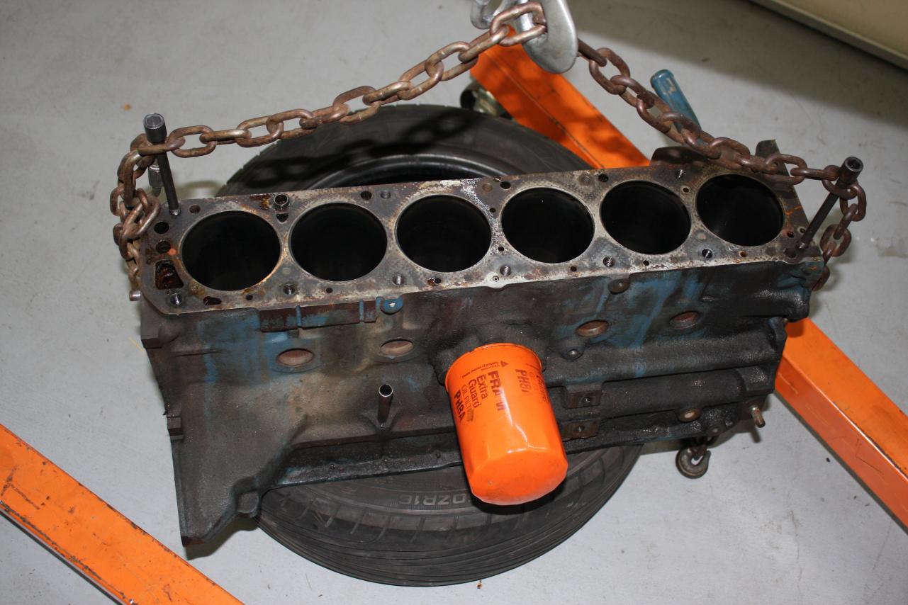

Posted May 30, 201114 yr comment_357339 I'm building a new engine. I'll use the L28 N42 block bored .040 over with an L24 crank and rods, L28 P79 flat-top pistons and a high quench P79 head shaved and shimmed .080 inches (should be 9.2 to 1 C/R). What this will be is a very over-bored L24 because I really like the higher revving L24's and bigger is always better.....right? Anyone build this motor before or heard of anyone else building it? I'll update as I build on. Link to comment https://www.classiczcars.com/forums/topic/39741-new-engine/ Share on other sites More sharing options...

May 31, 201114 yr Author comment_357391 Isky Stage II........480 lift......Stainless steel swirl valves.......balancing the bottom end. Link to comment https://www.classiczcars.com/forums/topic/39741-new-engine/#findComment-357391 Share on other sites More sharing options...

May 31, 201114 yr comment_357396 Hi Guy,Sounds like a great combo of parts there buddy. Should be a very nice revver. Please don't put a stock damper and flywheel on the beast will you? The L24 revs well because of the rod to stroke ratio as you're aware. I've just screwed together my new L28 and thought long and hard about those sorts of details so that's why I had custom rods built to suit my JE forged 300ZXTT pistons. Now I have an L28 with a 1.72 rod to stroke ratio (and a bit closer to your much better 1.8 than the original L28's 1.64). All the best mate. Let us know how it all progresses. :classic:Cheers.Ps I have an L20A crank and spare N42 block and......:bulb: Edited May 31, 201114 yr by ozconnection Link to comment https://www.classiczcars.com/forums/topic/39741-new-engine/#findComment-357396 Share on other sites More sharing options...

May 31, 201114 yr Author comment_357403 OZ......You know I'm building this motor because of our conversation last year! The P79 head shaved and shimmed gives a ratio of 9.2 to 1 while the E31 gives you 9.7 to 1. I have both heads available, but decided on the P79 for the better burn and flow. Do you agree? This engine ought to be a sweet driver.......we'll see. Guy Link to comment https://www.classiczcars.com/forums/topic/39741-new-engine/#findComment-357403 Share on other sites More sharing options...
