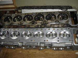

What do y'all think?  I've tried to get it as close to a P79 as I can.  It's not perfect by no means but I'm getting sick of grinding and polishing the combustion chambers.  I'm going to port match the head to the manifold tomorrow.  Then soda blast this weekend and give it to the machinist Monday, so I have time to make corrections that somebody can point out.
thanks for looking and critiquing
Cliff

Looks great Cliff
looks beautiful - exciting to see the progress!

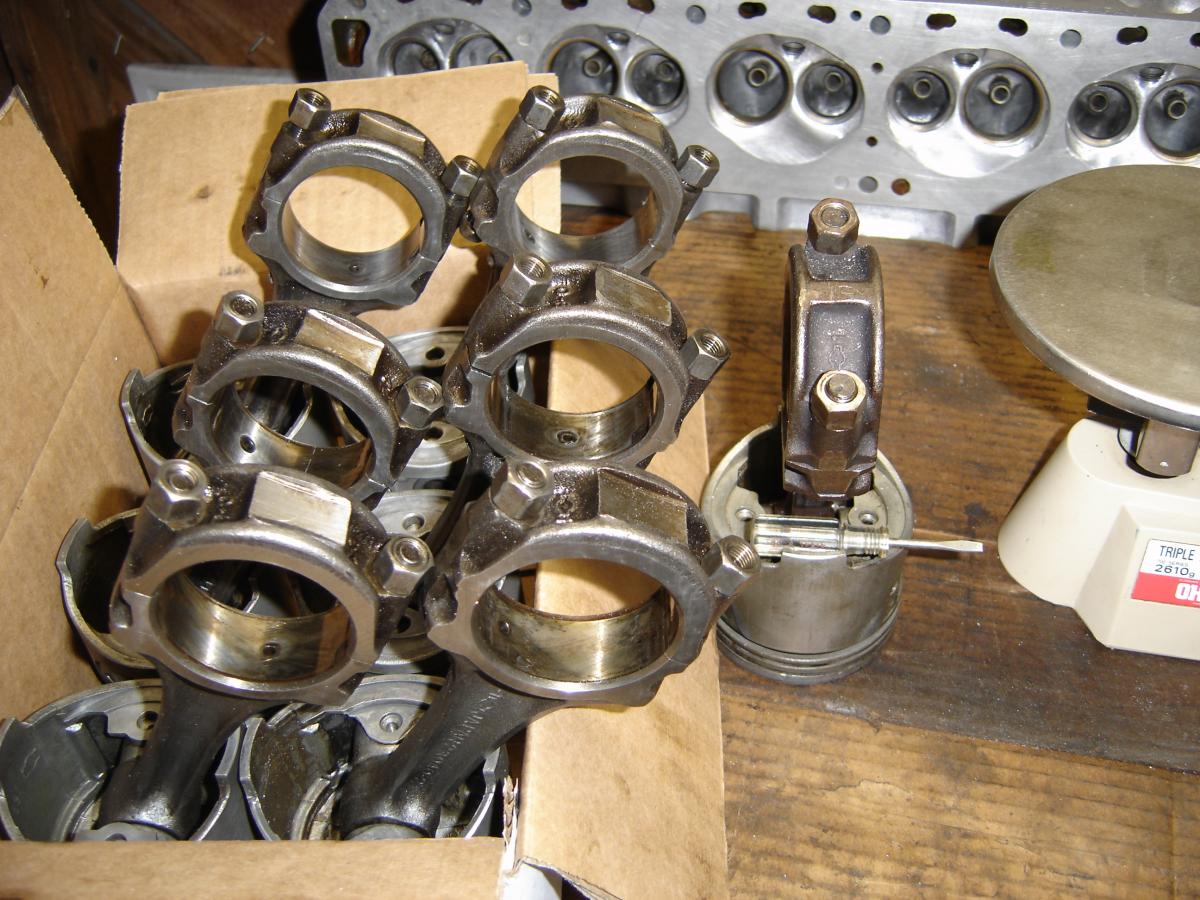

Weighed my pistons today and the lightest is 384.5 grams which happens to be #1.  Number two weighs the most, 390.7g.  I'll get them all the same tomorrow.  I noticed how Nissan balanced them, ground a flat spot on the rod cap, so I'll do the same.  These are different from another set of 2.4s.  They're lighter and have smaller rod bolts.  In the picture you can see the 6 I'm using and  one off to the right that's from a different motor.  Also have the rear main seal from Nissan's part number and price, $31 out the door, but I'll have to reuse my nails.
Anyway glad to be greasy again, times a wastin'.

Most times I balance pistons and rods separately. The location of the weight can make a difference. That may be overkill...
Charles
Most times I balance pistons and rods separately. The location of the weight can make a difference. That may be overkill...Charles
Those wrist pins don't come out as easy a my boat motors did. Deep socket and a short sledge hammer would drive them out but not these Datsuns.
