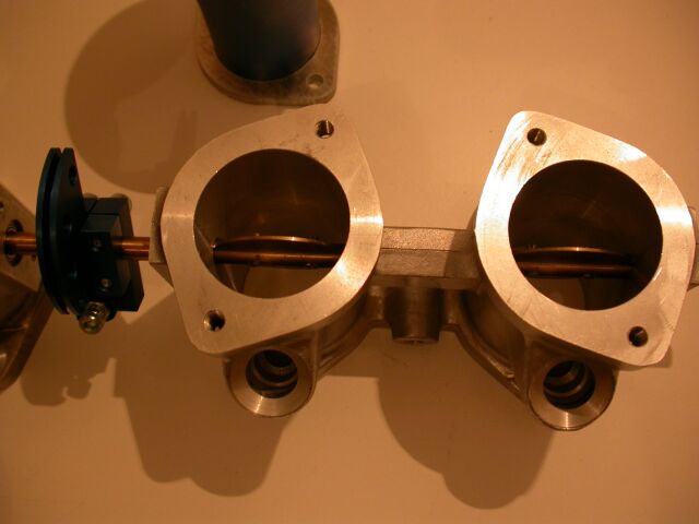

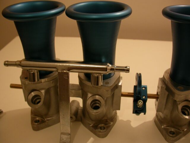

Hi All,
I have a set of 45mm throttle bodies that are Webber bolt pattern. I bought these brand new and was going to install it on an L18 in a Datsun P510.
I have since sold the car and will now get one more throttle body so that I can build a nice L28 to go with it all...
