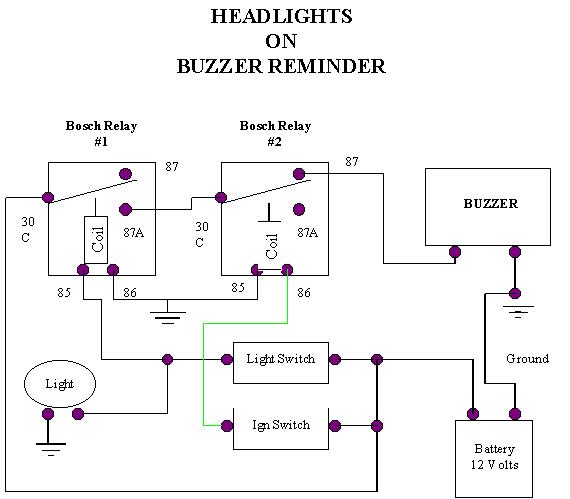

Basically this system operate on the following principle.
When the ignition switch is activate, the internal coil of relay #2 is energized and no current reaches the buzzer so no sound is heard regardless of headlight positon.
When the headlights are on, the internal coil of relay #1 is energized and battery current is passed through relay #1 to relay #2. If the key is off then current flows through relay #2 to sounds the buzzer. If the key is on then relay #2 is energized and no current reaches the buzzer.
Use of a chime will be more appealing.
It's as simply as that!
List of Materials:
a) 2-bosch relays single pole doube throw (SPDT)
B) 12 volt buzzer or chime
c) Solderless teminals
d) Electrical wire
e) Board to install components
TWO relays!??
Only the buzzer should be needed, and it does work on American cars, so the same simple nbuzzer should work on the Z, with the exception of a simple addition, like a diode or something like that.
I think you've over-engineered this idea Ezzzz. First make the buzzer work with the stuff that's there.

I was only trying to have some fun. Read on as there is reason in my madness. My circuit does not rely on the ignition for a ground source. It really isn't that difficult. A simple buzzer can be found at Radio Shack. They probably have a chime as well. In your desired version one buzzer lead goes to a terminal that is feeding 12v to the side or dash lights (these are the last to go when turning off your lights). The other lead goes to an ignition source. When the ignition is off but the lights are on the buzzer/chime uses the ignition load(s) as it's ground source (abet it is not a straight ground). In this scenario the ignition circuit is drawing all required current through the buzzer/chime too. It may be enough to cook the little bugger it heavier loads (i.e. electric fan) aren't load relayed and should kick in. Otherwise, that simple circuit should work in nearly every application. My old Land Rover has seperate switches for internal/parking lights and the headlights. A bit more creative approach would needed in such a case. :ermm:
