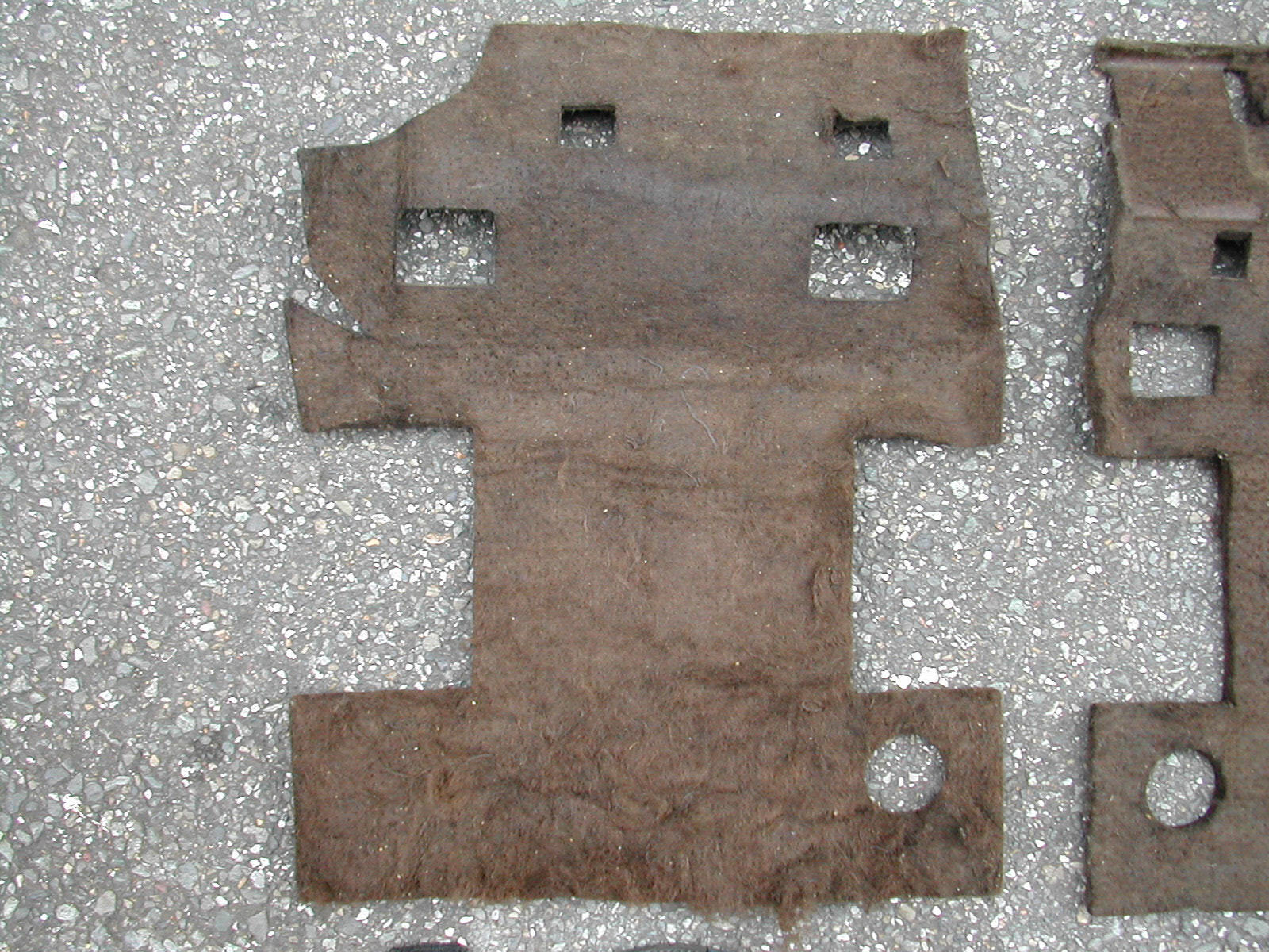

But there is an answer in a Fairlady Z parts catalog . It lists for both , 74922-E4100 for Right side , 74923-E4100 for Left side. As you can see from this , they can be fit for both RHD S30 and LHD S30 cars , just need to switch L and R accordingly.
But even a Fairlady Z parts catalog, it doesn’t list different parts numbers for cars when they have a reinforcement on the floor under the seat bottoms ( probably around April or May 1970 )  . Those cars have two piece jute divided by the reinforcement. Nissan didn’t think about it needs to list? Just cut them half and put them on !
And Dan , your NOS one has a unique feature, I am guessing that is for only very early cars like up to Jan 1970 .
Two square cut outs for Velcro fasteners.
My March 1970 240Z doesn’t have the cut outs ,
again Nissan didn’t think about applying a new part number for deletion of the cut outs .

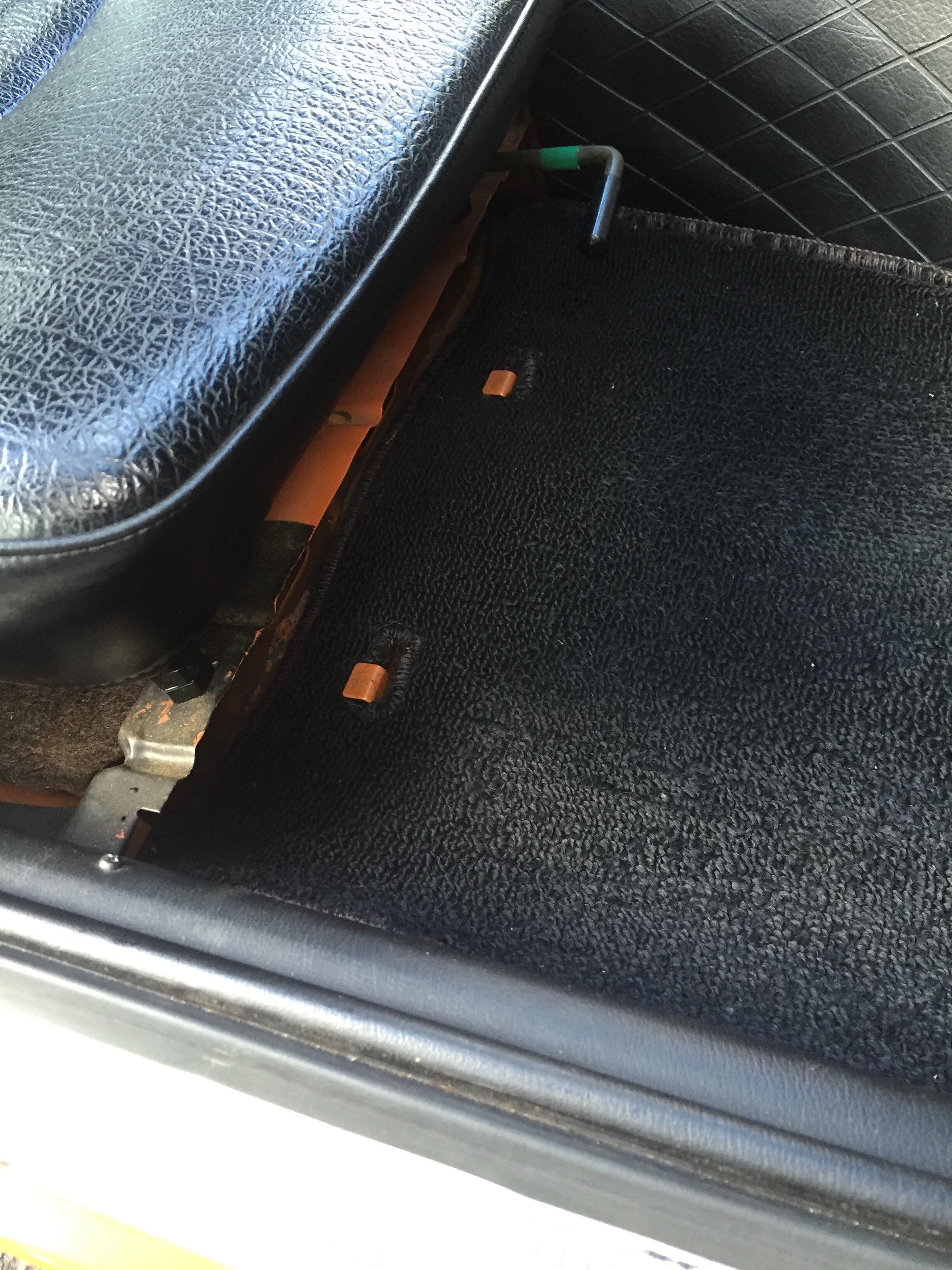

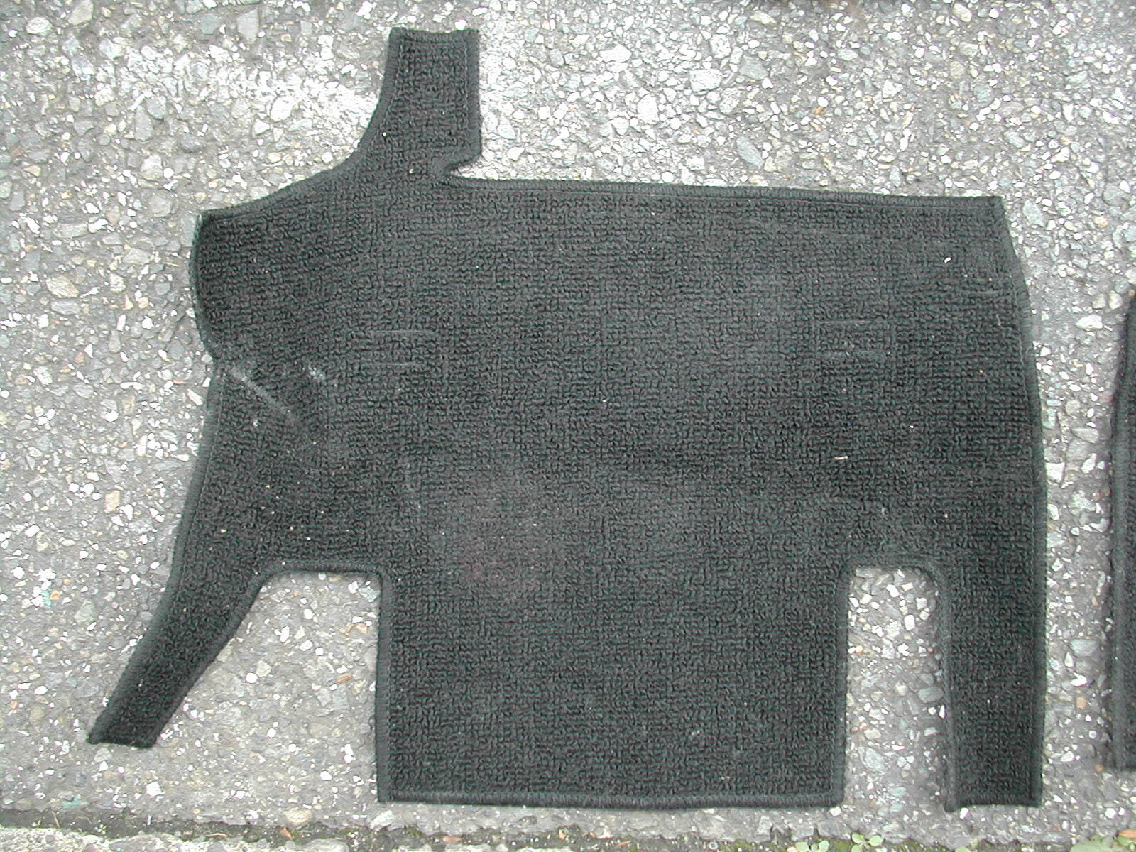

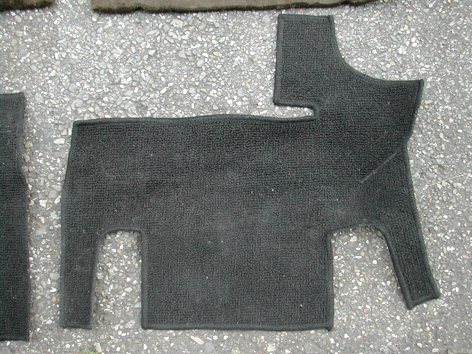

I show the jute pictures again which are provided my Z432 friend Watanabe san . His car registered in Dec 1969 , PS30-00063 .
And Keith , I am very interested in your comments about early US cars have carpet set in the US . Look at Watanabe san’s carpet , I see beautiful loop pile .But I have been wondering why my US 240Z ‘s carpet looked different .
If it is true , I will regret that I threw away my HLS30-02156 ‘s carpet set because they looked aftermarket for the car.
Let’s find out.
Let’s find out.
Kats

Hi Keith, Watanabe san’s car is a Z432 , PS30-00063 December 1969 .
Fairlady Z-L and Fairlady 240Z-L and Fairlady 240ZG have  almost same goodies like Z432 . Carpet set including for side sill rails, stop watch , 8 track tape and radio player with a dual speakers , passing light switch , etc etc .
Kats

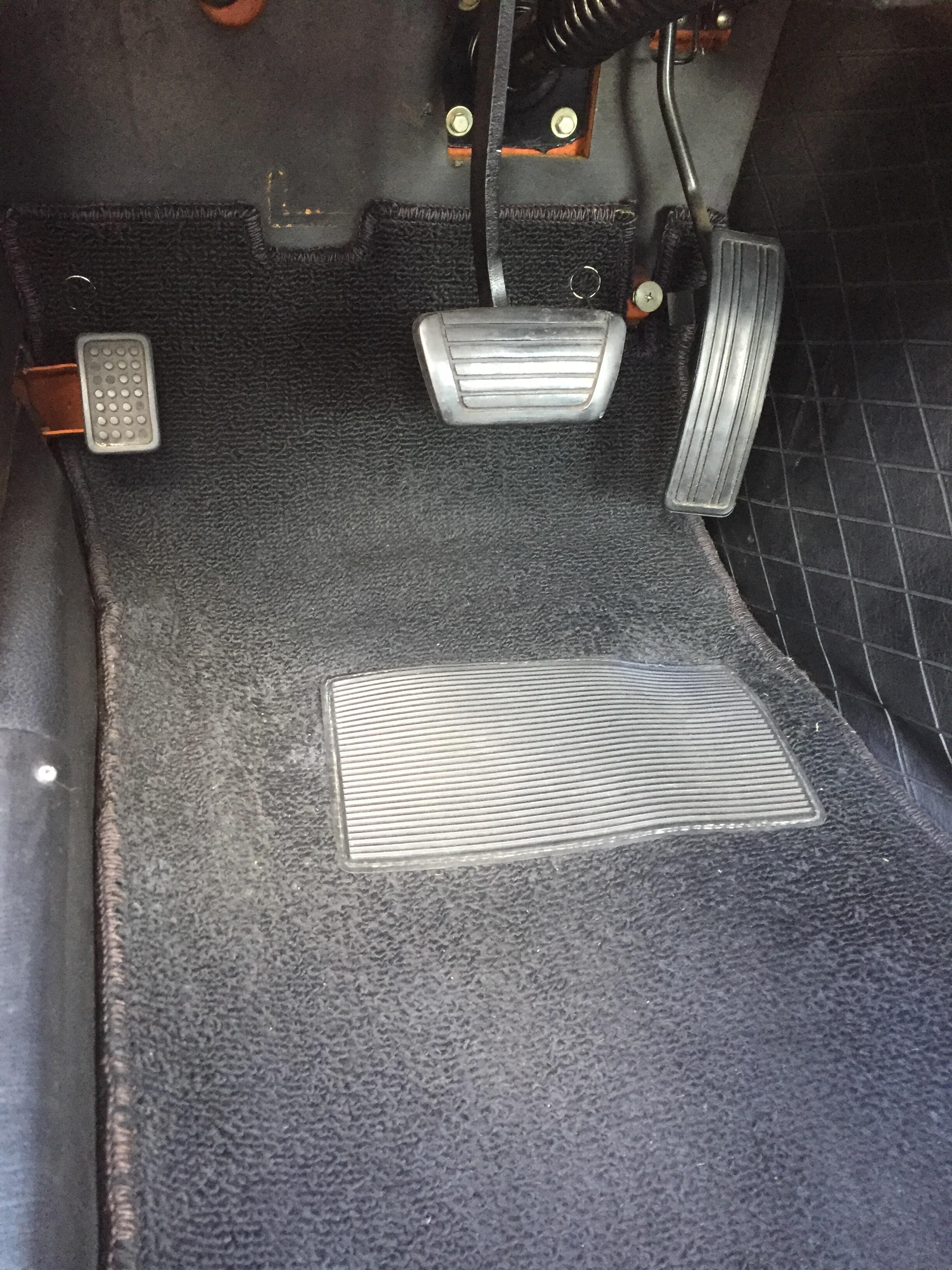

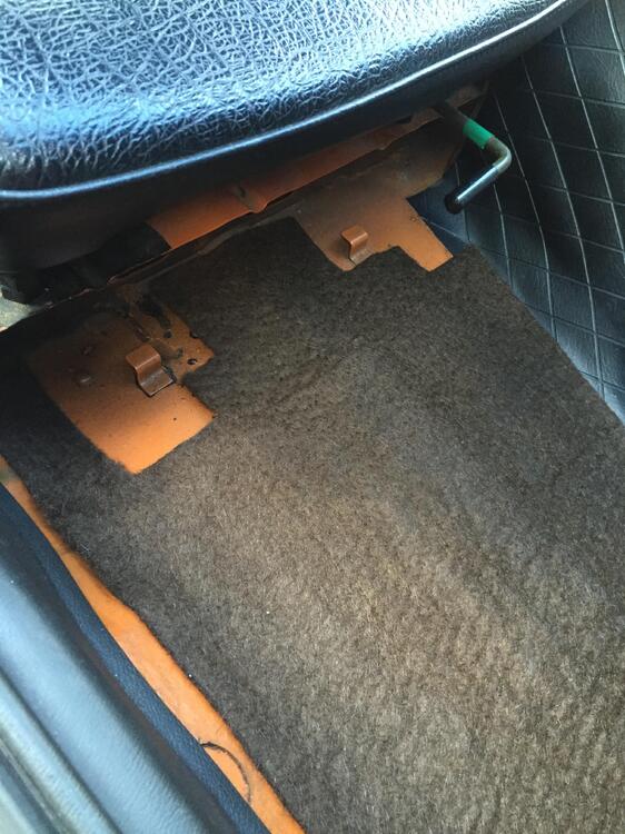

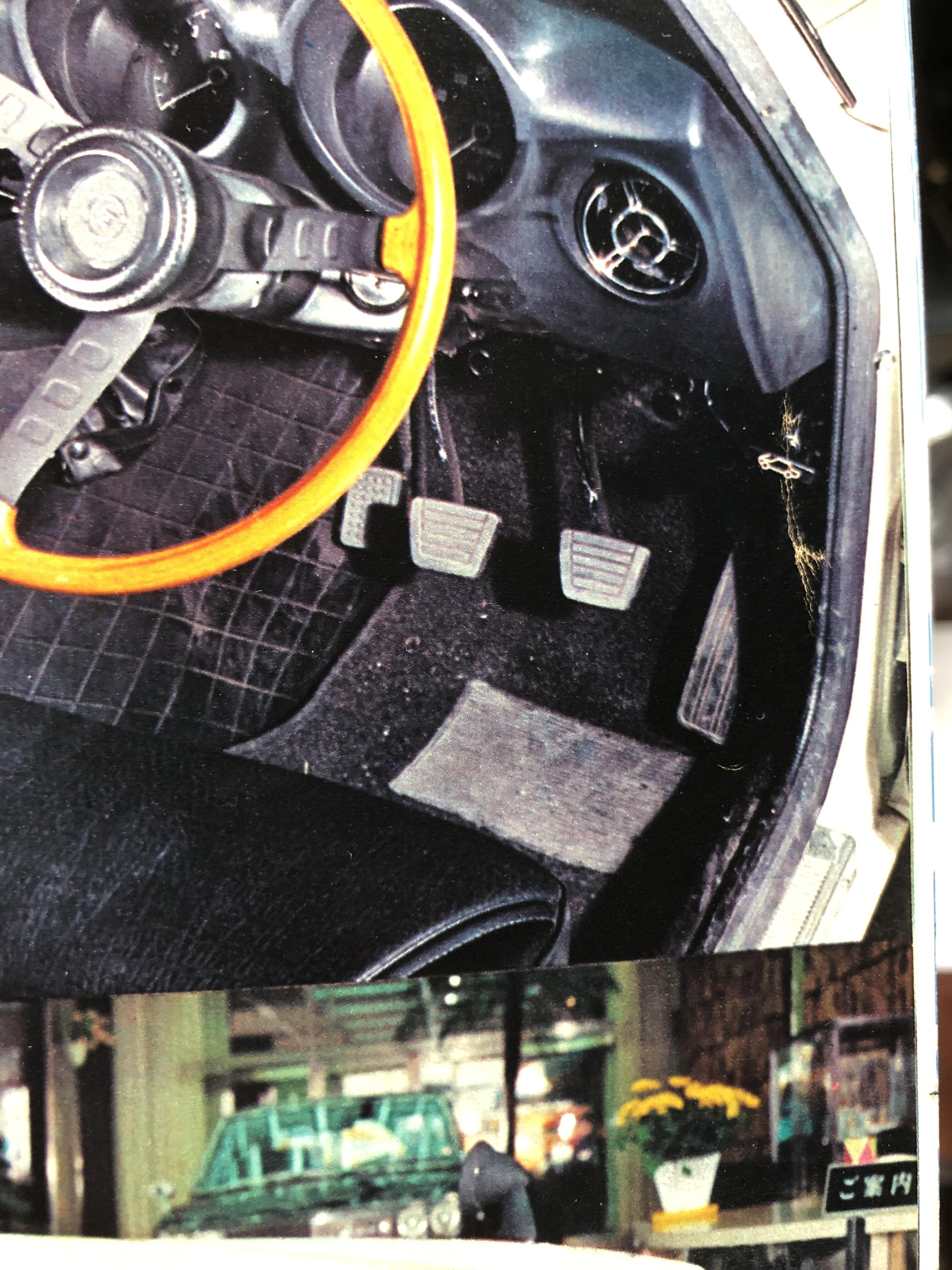

Kats,
I believe the "L" vehicles had some "luxury" features, including the driver and passenger floor carpeting.
My 1970 circa heel pad is shown below
Please post a photo of Watanabe san’s car's heel pad.
Thanks,
Keith
Before getting back from Watanabe san , here are some pictures from 1969 cars at Tokyo Motor show , and Nissan Ginza head office gallery.The color pictures are 1969 Fairlady
Z-L . As a side note , there are some indications which tell us this car is super early. No hood bumpers , tiny rubber bumpers on the inspection lid , etc .
Kats

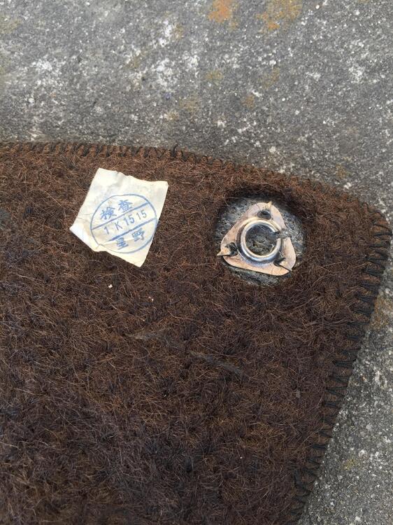

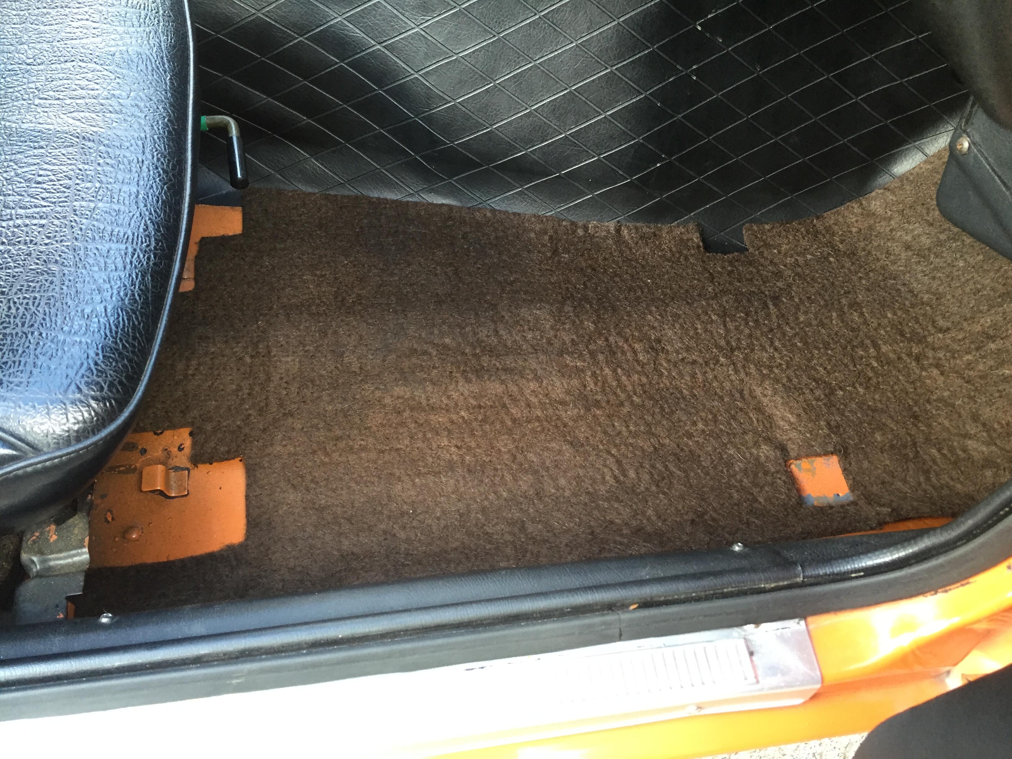

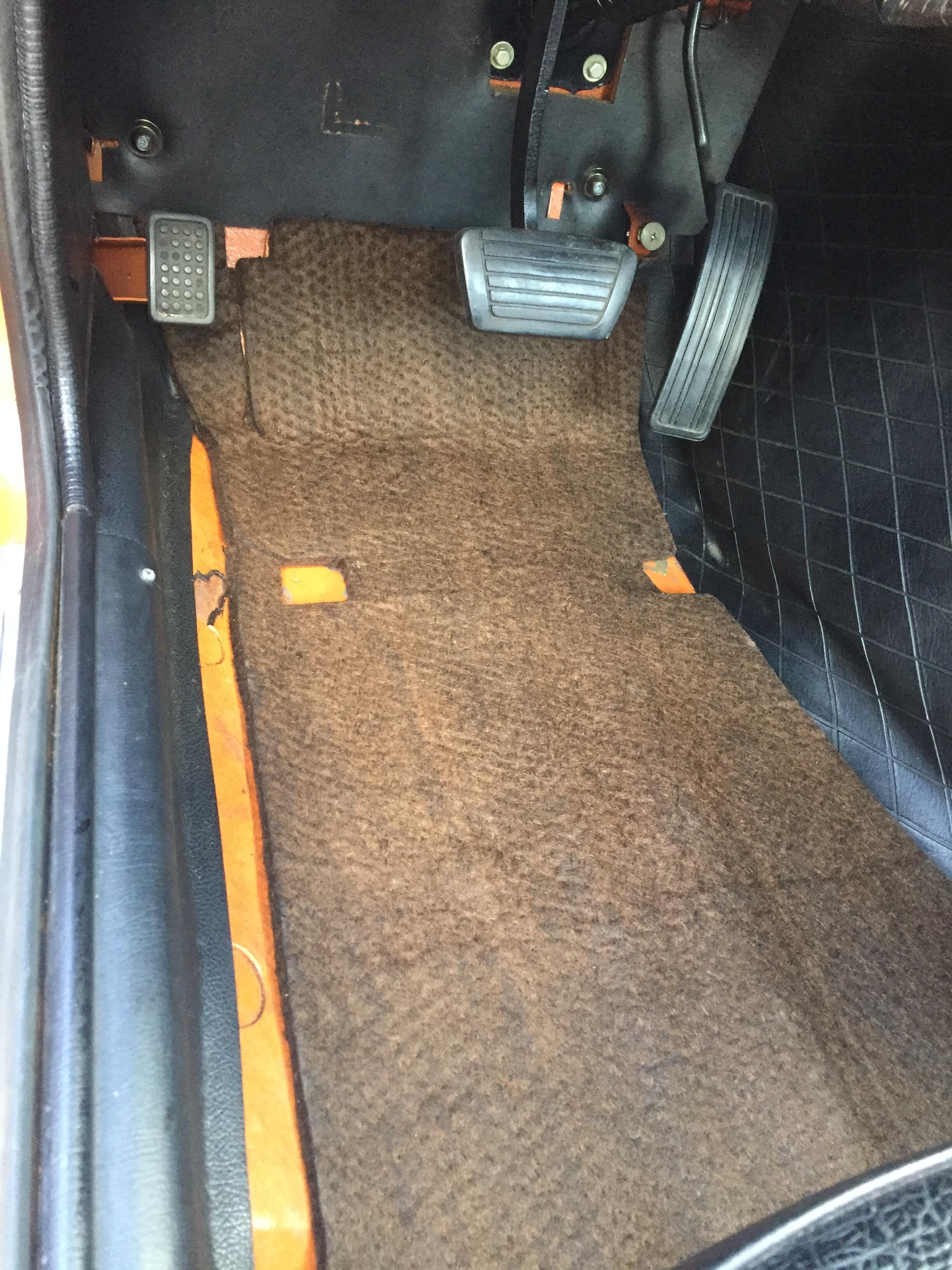

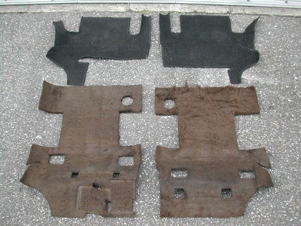

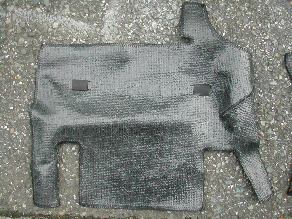

Just for your reference, a set of jute and carpet of my Dec 1971 US 240Z which I sold it in 2021. I can't see the circular cut out which can be seen on earlier car.
Kats
Hi Keith, yes the jute is sewn to the carpet , looks like it is original , an inspection stamp has an inspector name “ Hoshino “ on it , 1 K 15  15 will mean 1971 November 15th , the last ‘15’ is still unknown.
This car has a set of 5 pieces carpet and 5 pieces of jute , all carpets have this inspection stamp at the back .
Yes I think so too , the heel pad looked to be the same as yours , interesting!
Kats
