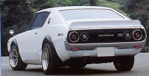

As you may or may not know, I'm currently turning my 240K into a Skyline GT-R replica. Anyways, I'm trying to get some Watanabes at the moment and I'm just having a hard time working out how wide I can go!?
I've attached a couple of pictures to let you get the idea, and I was hoping some of you who have a bit of experience might be able to suggest the widest wheel that could fit under the flares.

Attached: Skyline with flares (picture thanks to Alan T)

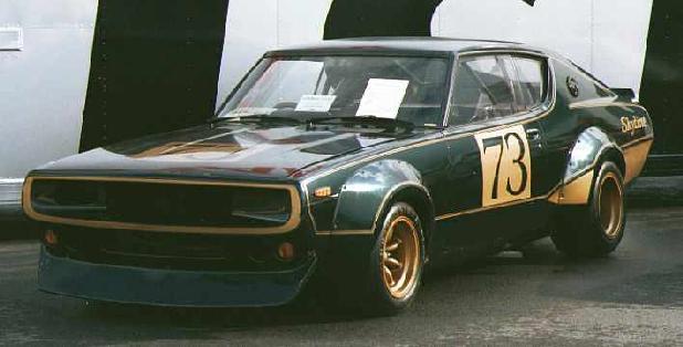

And for fun, the green mean machine! (note I'm not getting THESE flares)
Kinda hard to guess at the width on the white car, but I'd say either 7.5 to 9 inches... 8 inch would probably be a good size for the rear, but I'm wondering if you can run the same size all around. Maybe 7 in the front and 8 in the back?:ermm:
FWIW, I like the green and gold car better....:devious: looks like it has close to 10 wide in the back and maybe 8 to 9 in the front....
be nice to take that one for a "test drive".....:cross-eye
Hi Alfadog,
The white car in the photo has 8.5J on the front and 9.5J on the rear according to the photo caption. They are 15 inch, and he is using a quite narrow rear tyre stretched across the rim. Ideally the tyre would be wider, but these young guys in Japan seem to be happy to stretch a tyre a bit further than the pros would advise......
Don't forget that the 15 inchers are going to be more expensive than 14 inchers if you are buying used ones. There's a good reason for that, and its to do with tyres. Basically, you have a lot more choice of tyres for the 15 inchers than the 14 inchers.
Also, don't forget about wheel offset. That's going to be more critical than the actual rim width up to a point. You need a lot of negative offset for this look ( the rims will look to have more 'dish' when viewed from the outside ) and if the offset is too positive you'll be hitting your springs and / or inner arches.
Personally, I'd have a look around at tyre choices before settling on a final rim size. You can stretch the tyres like they do in Japan, but I would not take it too far if I were you.
With the C110 GT-R type of 'Overfenders' ( as on the white car in the pic ) you would not be wanting to go wider than the 8.5 front and 9.5 rear. My recommendation would be to stick to around 7.5 to 8J front and 8J to 9J rear with the correct offsets.

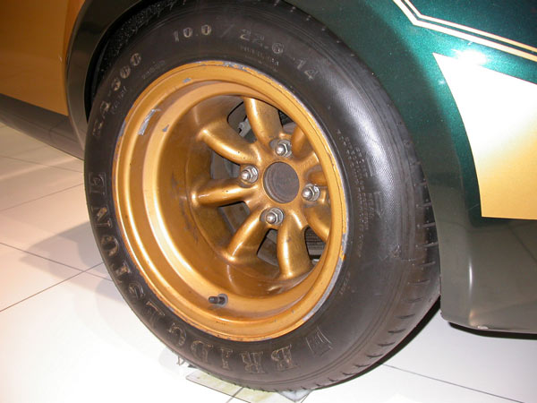

ps - here's a pic of the "Works" '73 KPGC110 rear wheel. That's an 11J rim, and its not an RS Watanabe.
I like the look of the white car, the Green and Gold looks too much like a Camaro!
