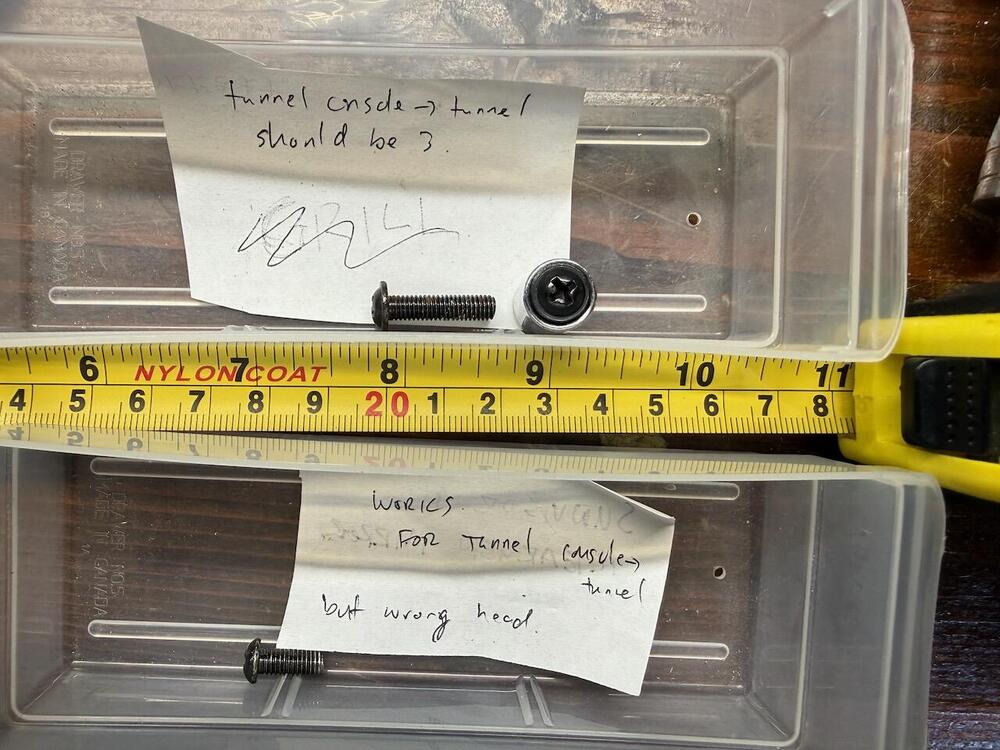

I am trying to get this car back to closer to original. For the 3 bolts that secure the tunnel console to the tunnel (the ones you see I mean), what are they supposed to be? I have a hard time seeing the shape in BAT photos. I only found 2 when reassembling my car. They have kind of a lip around them, but are flat (no shoulder). Seems an odd choice to use for the fiberglass tunnel, where the holes are kind of rounded (at least on mine, FWIW).
I have unrelated bolts I could use, but would like to use original hardware where possible.

Thanks. I might have mixed up the bolts for this and the ones for the heater/radio console. Or not, haven't checked what those are supposed to be yet.

so both locations are, according to this anyway, the same size. So I think that's M5 12mm length.
