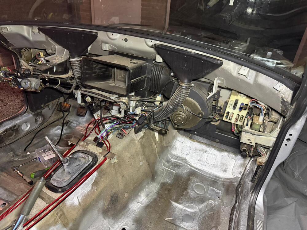

Removing the dashboard is pretty easy, I just DIY restored mine on my 1977 280z. Even though I have a 280z I believe the 240z should be about the same.
For me I just had to remove the steering wheel, disconnect the three plugs in the passenger side footwell, loosen six bolts up top (under the vent cover, two in the middle end two on each side) and four bolts on the bottom behind the center console. The last step is to disconnect the speedometer cable (might need players for that) and then just pull her out.
Removing the dashboard is doable by yourself but a second person makes it a lot easier as the dashboard is pretty heavy.

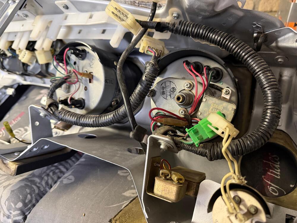

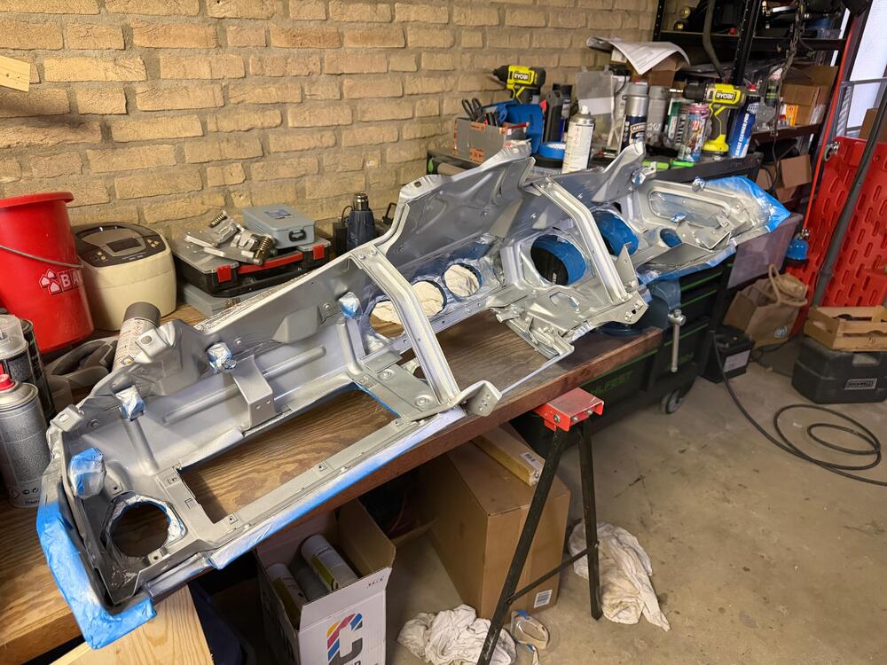

Here are also a couple pictures I have on hand that might help you a bit with locating bolt holes, electrical connectors or the speedometer cable.
