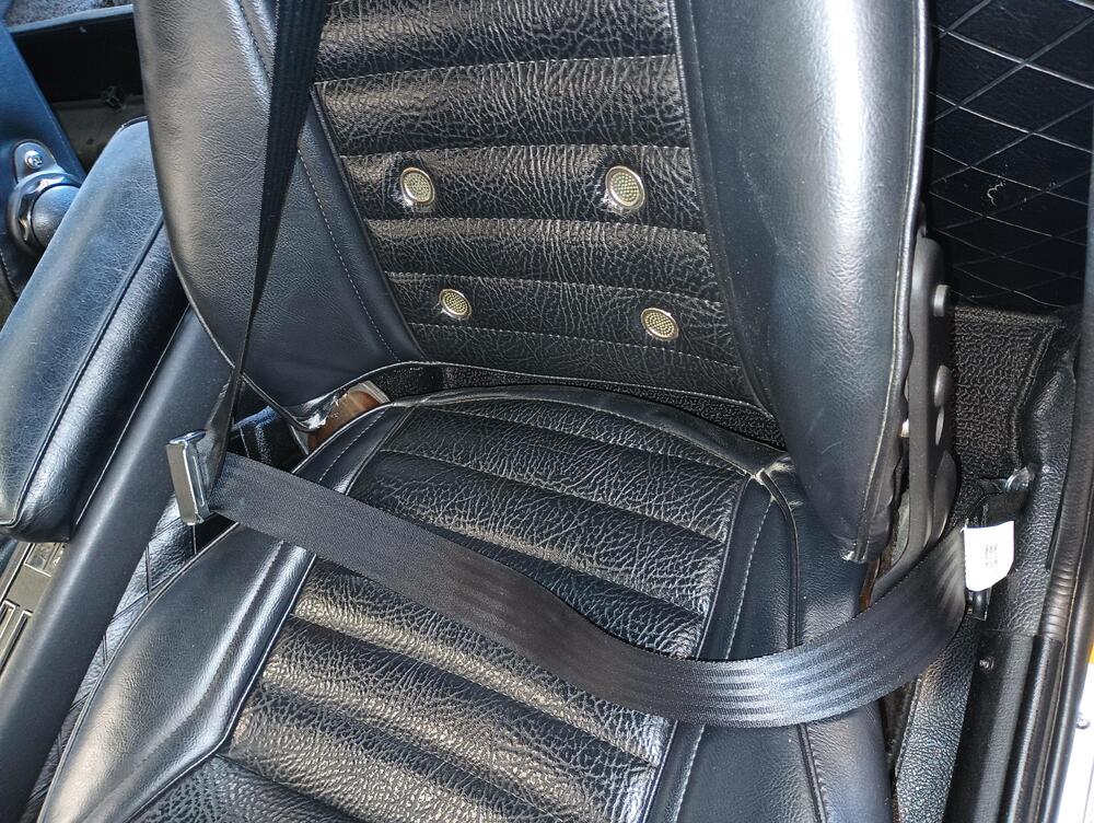

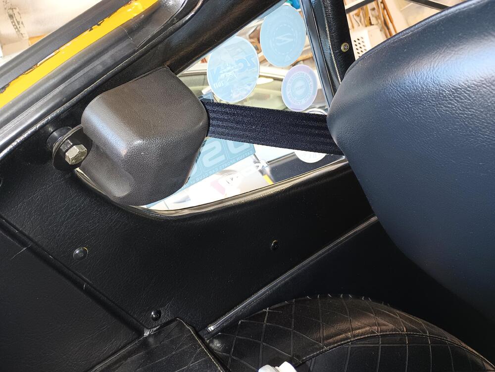

I have the Wesco Roadster Retractable belts installed in my Series 1. The retractor unit is installed at the shoulder belt mount point above the quarter window, easy to operate and very comfortable. I used the OE bolts for the install, no need for a hardware kit. If you decide on these, get the 11" rigid sleeve.
I've also done the Wesco Roadster belts in my early 71 240Z.
