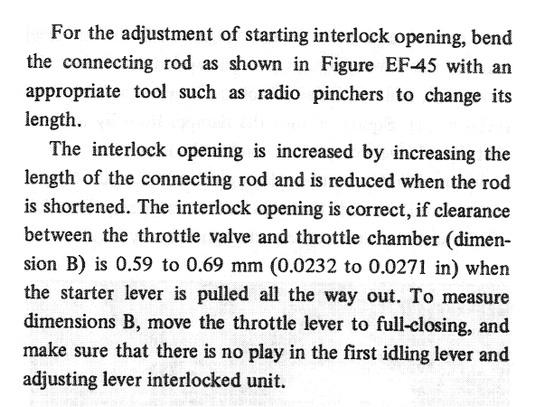

"For the adjustment of the starting interlock opening, bend the connecting rod (4) as shown in Figure EF-45 with an appropriate tool such as radio pinchers to change its length."
I have done this.  When I did, the carburetors idle set screws had already been set properly, and the carbs synchronized.  With the choke lever in the closed position, the lever that the connecting rod operates is not in contact with the throttle plate linkage.
When the choke lever is pulled the connecting rod pulls on the lever, and the tab at the other end of the lever contacts the throttle plate linkage.

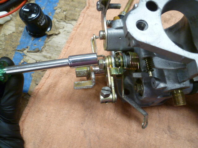

To set the clearance of the throttle plate59 to .62 mm "throttle valve" to the carburetor body "throttle chamber" to the proper specification, ".59 to .62 mm (.0232 - .0271 in)", I flattened a piece of annealed wire with a hammer and the flat portion of my vise.  I measured it with vernier calipers.  When it was the right thickness, I used it as a custom feeler gauge.  I inserted it in the carburetor port between the throttle plate and bore and adjusted the length of the connecting rod to set the gap.  Now, when I pull on the choke lever, both linkages activate and open the throttle plates from their previous open location (as set by the idle set screws for proper idle when the chokes are not operating) to the correct specification.

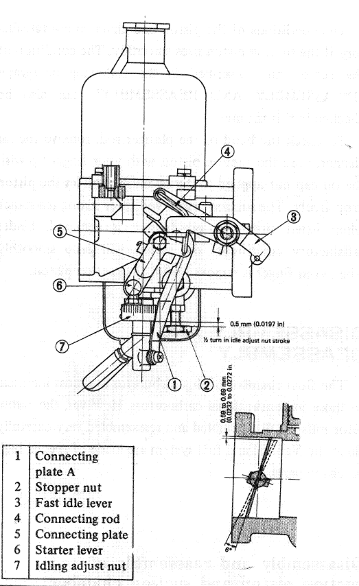

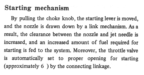

So far, I have only been describing what happens to the connecting rod/lever/throttle plate when one operates the choke.  However, there is another part which is important in the functionality of the system: the nozzle.  As the choke lever is operated from closed to open, there is a point in that travel where the (1) "Connecting plate A engages.  When it does, it pulls the jet nozzle downward.  As explained in the workshop manual:
Here is the problem I have right now with my car.  When I pull the choke cable as far as it will go, the nozzles bind in the nozzle sleeves.  Pushing choke lever forward, to disengage the starters is not sufficient to put the nozzles fully back into the nozzle sleeve.  Instead, I have to tap on the bottoms of the nozzles with my fingers to get them to unstick and return.
To address this problem, I am now focused on this:

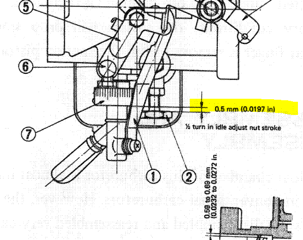

According to the workshop manual, that (2) stopper nut is supposed to be set so the idling adjust nuts can only be turned out 1/2 of a turn (from their operating position which is 2.2 turns down).  One half a turn, is only .5 mm!
If that was set properly on my car, that means the nozzles would only drop .5 mm when the choke lever is pulled.  Can that be right?

Let's start with the simple... That 0.5 mm (half turn of the knob) will not limit the amount of nozzle drop when you pull the choke lever. That 0.5 mm limit is simply an attempt by the factory to prevent you from adjusting your carb nozzles four or five turns down and driving around like that. It's an emissions stop limit so you don't accidentally (or on purpose) set your nozzle operation way too rich.
Ah, yeah right.  The nozzle and the connecting plate A are the only parts that drop... not the idling mixture nut.  So the stopper is not in play.

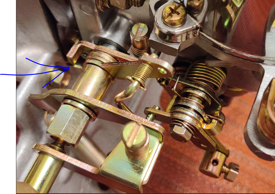

 When my nozzles started sticking in the down position, I removed the carbs and found the #1 bar warped. The ends were not parallel to their attachment points. A slight twist with two pairs of pliers on the bar realigned the ends of bar #1 with their mounting points. That ended the problem with the nozzles.

I tweaked the #1 bar a bit on the back carburetor and was able to achieve smooth up and down movement of the nozzle.  I tested its movement repeatedly.  That one is good!  I am in the middle of doing the same thing to the bar on the front carburetor to get the front nozzle to stop sticking.  Evidently, these bars have to be in quite a particular shape, or they allow a sideways force on the nozzle that can cause it to stick when it is extended out of the nozzle sleeve.
