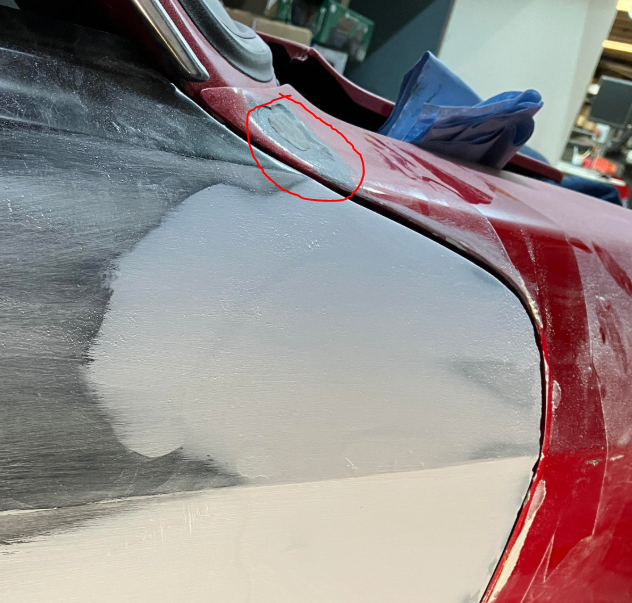

So I went ahead and started the body filler work. Keep in mind this is a driver and I never would have accepted this if it wasn’t. Here is a shot after building up the area with Duraglass and then filler. It’s still rough because I finished it off the car but it will give you an idea as to how much work I had to do to fix that gap.
Here is an edge shot of just how bad it was:
I sent Max the pictures for his records and told him:
“Not pretty and if it was a restoration it wouldn’t fly but for my daily driver that takes a beating it’s fine. The door I took off had no filler in that area and the fender has no filler in that area. The only conclusion I can come up with is there are variances in the assembly of your doors since the original one you sent me  fit even worse in that area.”

Honestly I'm not complaining about the exterior fit. It's the fact that there are so many inaccuracies in the critical mounting points. Like how can the hole for the hinge be off that far from one door to the next unless they are hand drilling them and then welding the nuts on based on the hole position. That means there is no fixturing at all.  Really the breaking point for me was when it was clear to me there was no way the drivers door panel was going on without totally disassembling the door and sawing the top ledge down to get rid of the extra 1.5MM of material. I'm really not too picky but I want door panels on the car 🙂

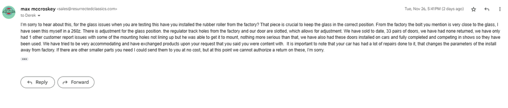

When the first door didn't look correct I told Max that previously I had done a lot of bodywork to the car but didn't think that was the issue. Here is a snip from his last email to me:
Quote
We have tried to be very accommodating and have exchanged products upon your request that you said you were content with.  It is important to note that your car has had a lot of repairs done to it, that changes the parameters of the install away from factory. If there are other smaller parts you need I could send them to you at no cost, but at this point we cannot authorize a return on these, I’m sorry.
How is that applicable to any of the problems with the holes being in the wrong place or the fact that the door panel won't go on. I'll let you draw your own conclusions as to the type of vendor they are. Also they exchanged one door not multiple "products".  I said I was content with the body filler situation. I never said I was content with the new problems.

Hello, I would like to begin by saying that I truly regret that it has come to this as I genuinely care about our products and I spend a lot of time on each part, the doors themselves took 3 years from concept to production and all of our products are tested on our own cars on site. We have a complete display car with all of our parts installed, it was at ZCON this year.
Firstly, the gap near the fender, when installing any body panel, the connected panels may need to be adjusted as well. The parts work in unison and you cannot just change one and not adjust the other one. I would also like to point out that from this picture, it looks like a fair amount of body filler was used on the fender, this would definitely effect the gap because the fender would be thicker.
From the pictures that were given, the hinge did not look like it would line up correctly, I took responsibility for this and delivered a new unit that you were able to test and confirm. I do not think it is fair to say that there was no QC on the doors or make comments on the manufacturing from a sample size of 1 unit. We have sold 33 pairs of doors to date, with zero returned. We have also had these doors installed and finished on cars that have won best in show at ZCON. For full transparency, we have had only 1 other customer issue a complaint about the doors that was later resolved, and not to the severity as is described here.
In our dialog I did ask if the factory rubber roller clip was installed, as this piece is crucial in positioning the glass, and I did not receive a response. I also explained that the regulator arm tracks have slotted holes for mounting, so there is adjustment for the glass as well. At no point did I stop communication or give up on trying to solve the issues you were describing, I just explained that a return would not be an option.  The statement here "Max doesn’t see it that way but he did offer me a discount on any future purchases:) Isn’t that special." Is entirely incorrect, my actual statement was that I would give you a smaller part of your choosing at no cost to you, not a future discount.
