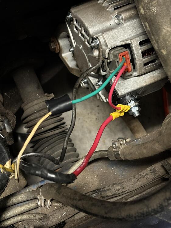

Here is how I hooked up the alternator, green wire to the yellow 12v and red to the b+. Voltage regulator plug (car side) jumped pins 1and 5 pins 2 and 3. IMG_7466.jpeg🤔

I just looked at your picture. You have it set up in "one wire" fashion (maybe, I need to know where the white with black goes to). Why?
You didn't say where you're measuring at. The B+ terminal or the battery. Can't tell where your wires are going.
Could still be a wiring problem.
