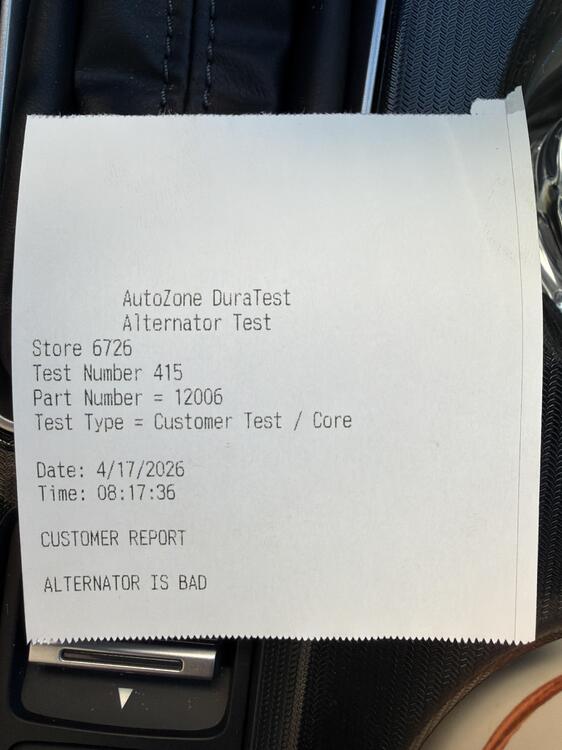

SteveJ was tremendous help, walked me through some meter testing and by the way it is a Frontier alternator. He was right, that’s a bad new alternator folks.
Thank you for posting your follow-up on here. Posting results can help other members in the future.
